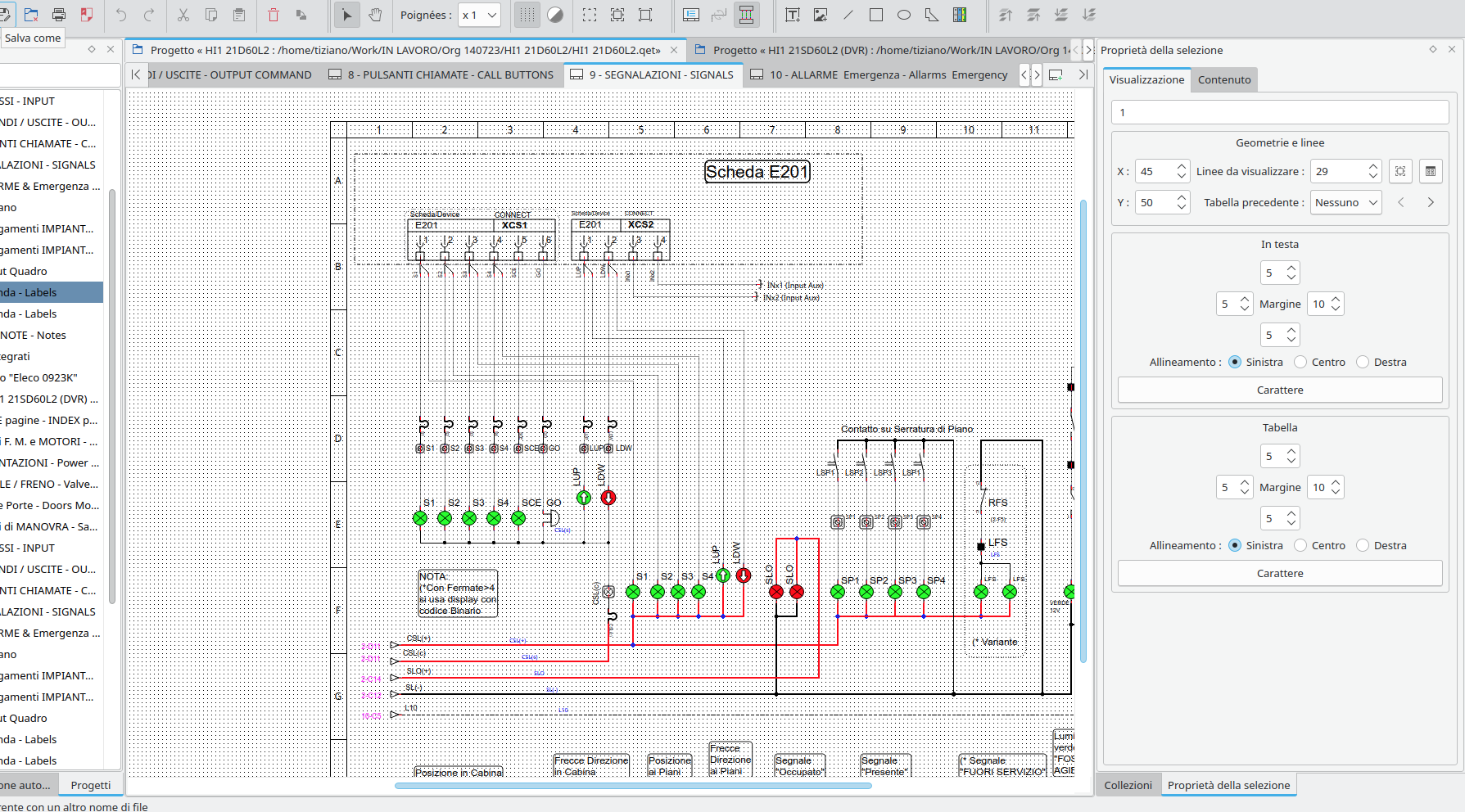

Why don't some conductors tick "text not visible"? That is, make the conductor reference invisible?
Each time I zoom them in to make the page as big as possible, but then it shrinks again.
Especially if the "Properties" view is activated.
Is there a way to lock the window size?
P.s.:
The reason to hide the conductor text is that sometimes it overlaps the text of element text causing confusion…
>In case the conductor text (+24E) overlaps the element text (+24E) and created a scribble.
And: the properties window, expanding, removes the view of the sheet one. Which often not performs the "zoom all" and does not align the sheet to the useful margin... So you have to move with the "little hand" if you want to see the whole sheet.
If the right window could fix, everything would be easier.

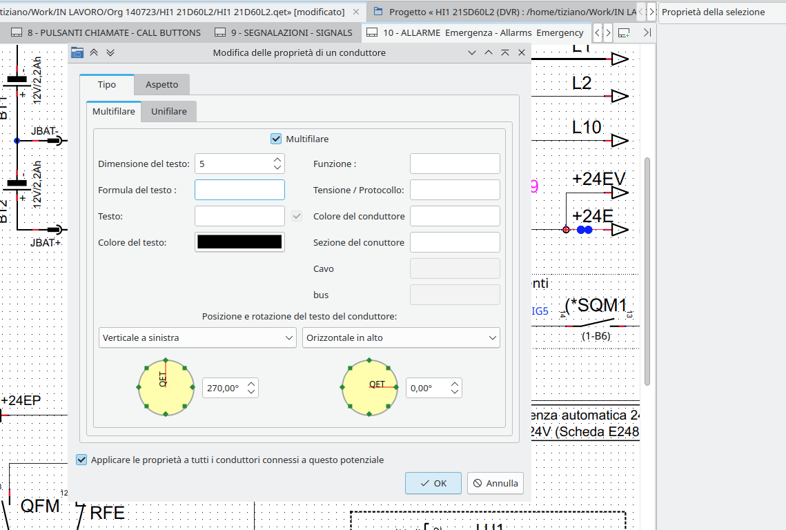

I think you may be able to solve your issue by selecting the tick box for "Show one text per folio potential"
This is located only in the Project Properties -> New Folio -> Conductor -> Type -> Multiline
It's very similar to the screen you show just with this one addition. This way for all conductors you'll only get the 1 wire number shown in each folio. (I'm not sure off the top of my head if this can be applied retrospectively or only takes effect when you make the next new folio)

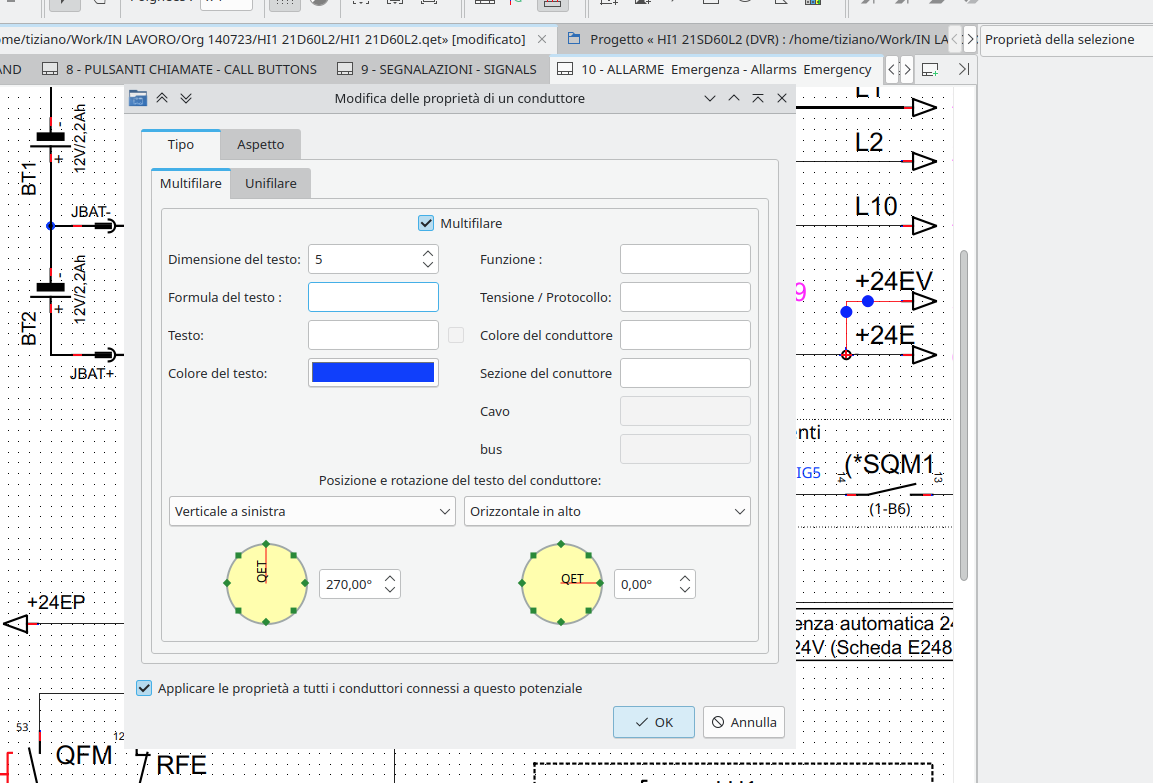

As you can see it's already set to multiline (on all sheets), only in some it allows me to uncheck it and on others it doesn't (it's blurry and I don't understand why it's blurry on the sheet link too).
