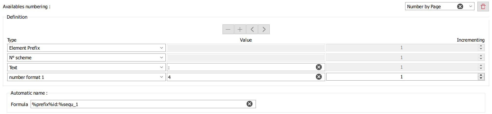

I am a fan of numbering elements by page. I was able to build a auto numbering filter for this, but my problem is every time I have added some elements to page 2, I switch to page 3 and then i have to reset the incremental number. So far it is a kind of workable but switching back to page 2, it means that i have to check where I was and set the incremental to where i was.
Is there a way to do this in a way it makes more sense?

Hello Martijn and thanks for compliments.
the automatic numbering tool is very rustic,
The easiest way for you to do this is to create rules by folio and by object.

Hello Martijn,
about the autonumbering, if I understand well what you need is to use "number format 1 Folio" instead of "number format 1"
Thanks Joshua! that's exactly what i meant I guess i missed it!
