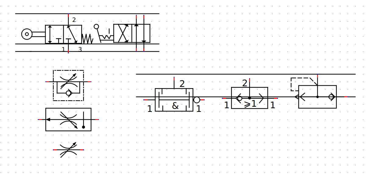

I wanted to draw a small pneumatic plan, but found that the quality of the elements is very poor.
The housings are of different sizes, the connector pins are in different positions ...
Is there an interest in the elements being redrawn?
Tell me if you're interested and I'll do it when I find time.
The elements have the same name only have to be exchanged.
Wishing a nice evening!

you are welcome, and yes I am interested in redrawing, if of course you have time to improve these pneumatic symbols.

I 200% agree, only one thing make sure the position of the terminals (red stick with blue dot) are in a multiple of 10. The blue dot must be in a cross not in a dot of the grid.
