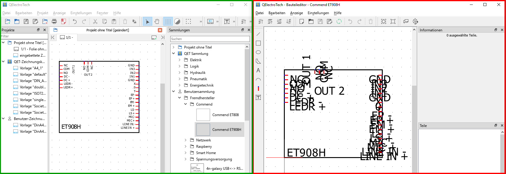

sometimes i'm facing the problem, that self-created elements are getting messed up / scrambled when i want to edit / view them in the element editor (please have a look at the attachment 'messed_up.png').
The strange thing is that they are only messed up in the element editor (red framed) but not when i drag and drop them to my schematics (green framed).
1.) Does anyone know why this happens and how to avoid this behaviour?
2.) Does anyone know how to edit messed up elements without starting from the scratch?

Re: Messed up / scrambled elements
Hi Aaron,
have you tried 0.9-dev?
Maybe delete QElectroTech key in regedit, is QET config.
Hi Aaron,
I saw the same problem in diagram editor and element editor, for me the problem is your file.
You use a laptop with two screens?
https://download.qelectrotech.org/qet/forum_img_2/Aaron_view.png
