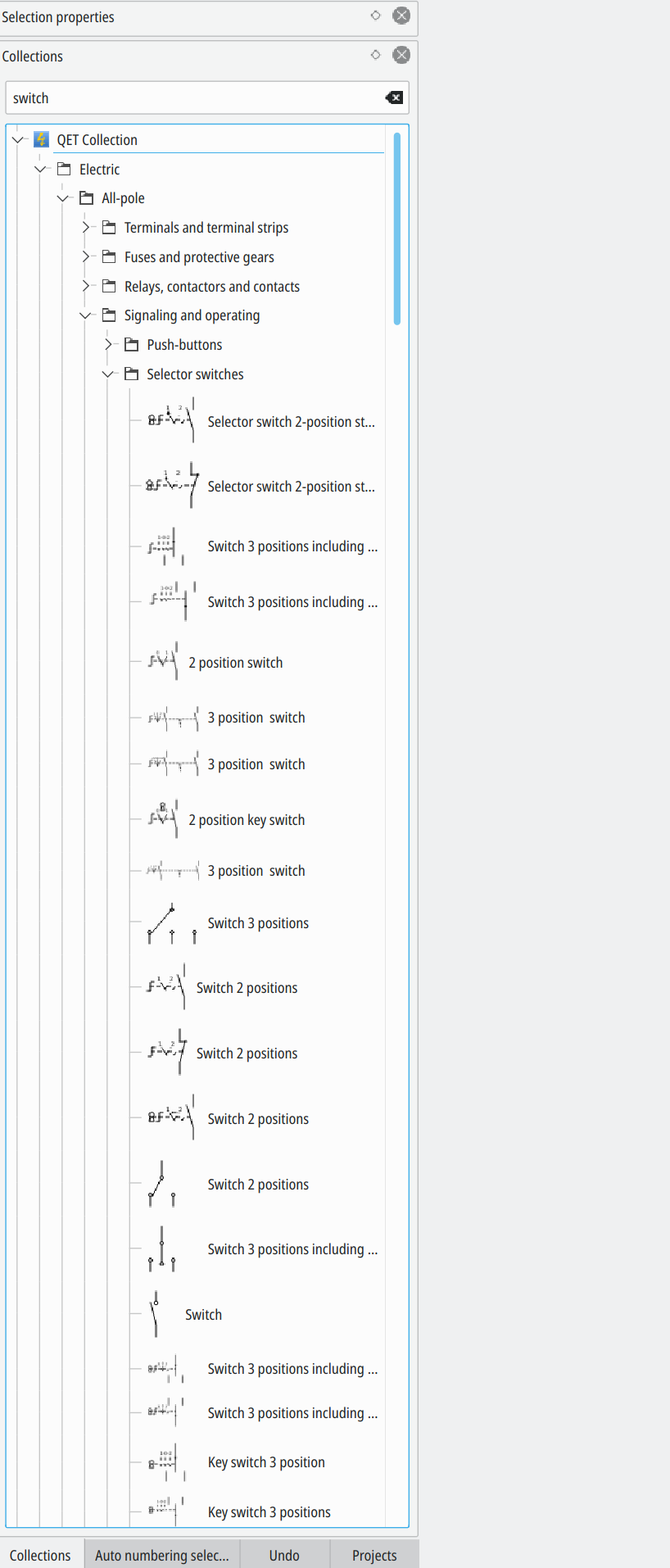

https://www.google.com/search?source=un … ch&sa=
Screenshot.png, 137.9 kb, 818 x 1914

Re: DSPT switch
@OCLC
You can use the contact provided by me with little effort.
with the required actuation type.
In the last post by Scorpio810
you can see on the screenshot different
actuations for switches.

Re: DSPT switch
@RedBaron: Thank you. I really think that such widely used element should be present in the standard QET collection.
@scorpio810: Sorry, you were right. I finally found it in the area that you pointed, it is called "Conmutateur bipolaire NO" in French, with the spelling mistake included!
- I didn't find it because I was searching for "switch", "contact", or "inter". With the spelling mistake in the name, I wouldn't have found it.
- There is no English description for that element, so the name was by default taken from language "ro" (the last one in the table probably). Isn't there a well defined fallback when the current language is not available? I think default fallback should be English (universal language today) or French (main language of the developers).
- There should be an English description for every element. Is there a repository to contribute for this?
- The link between the two switches of the "Conmutateur bipolaire NO" DPST switch is not drown in a standard way, is it? It should be a dashed line, as RedBaron and Wikipedia drew, no?
