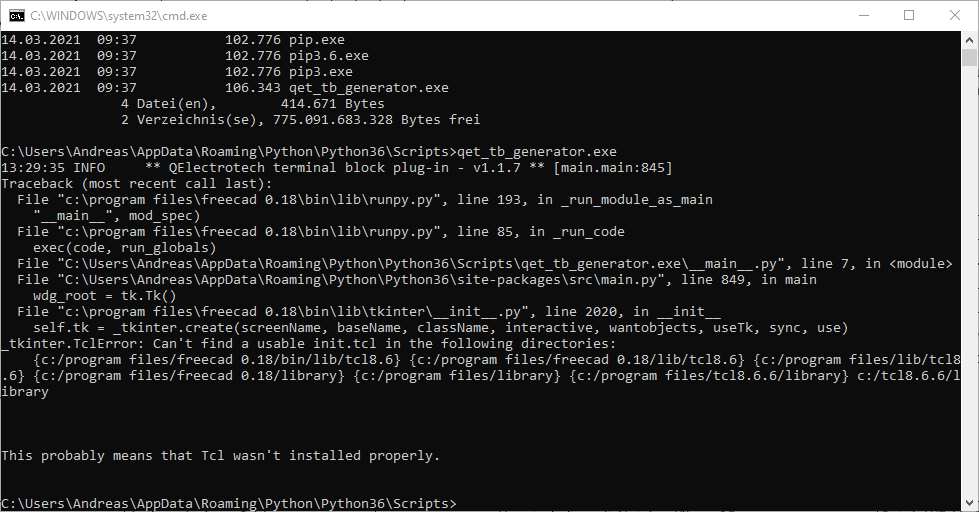

Folgende Fehlermeldung erhalte ich:
C:\Users\Andreas\AppData\Roaming\Python\Python36\Scripts>qet_tb_generator.exe
13:29:35 INFO     ** QElectrotech terminal block plug-in - v1.1.7 ** [main.main:845]
  File "c:\program files\freecad 0.18\bin\lib\runpy.py", line 193, in _run_module_as_main
    "__main__", mod_spec)
  File "c:\program files\freecad 0.18\bin\lib\runpy.py", line 85, in _run_code
    exec(code, run_globals)
  File "C:\Users\Andreas\AppData\Roaming\Python\Python36\Scripts\qet_tb_generator.exe\__main__.py", line 7, in <module>
  File "C:\Users\Andreas\AppData\Roaming\Python\Python36\site-packages\src\main.py", line 849, in main
    wdg_root = tk.Tk()
  File "c:\program files\freecad 0.18\bin\lib\tkinter\__init__.py", line 2020, in __init__
    self.tk = _tkinter.create(screenName, baseName, className, interactive, wantobjects, useTk, sync, use)
_tkinter.TclError: Can't find a usable init.tcl in the following directories:
    {c:/program files/freecad 0.18/bin/lib/tcl8.6} {c:/program files/freecad 0.18/lib/tcl8.6} {c:/program files/lib/tcl8.6} {c:/program files/freecad 0.18/library} {c:/program files/library} {c:/program files/tcl8.6.6/library} c:/tcl8.6.6/library
This probably means that Tcl wasn't installed properly.

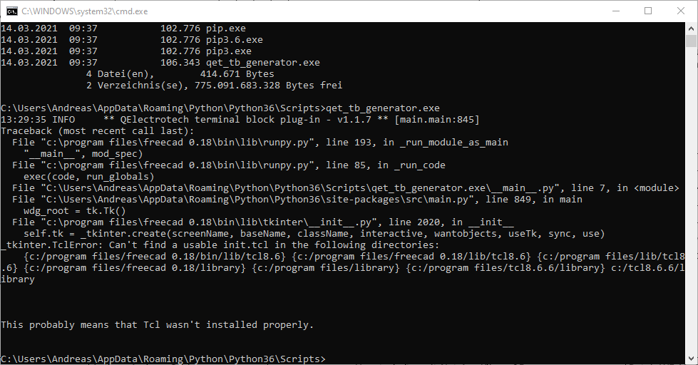

Tcl 8.6 is installed, the same error message appears again.
icrosoft Windows [Version 10.0.19042.867]
(c) 2020 Microsoft Corporation. Alle Rechte vorbehalten.
22:40:44 INFO     ** QElectrotech terminal block plug-in - v1.1.7 ** [main.main:845]
    wdg_root = tk.Tk()

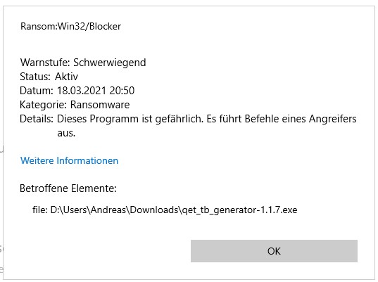

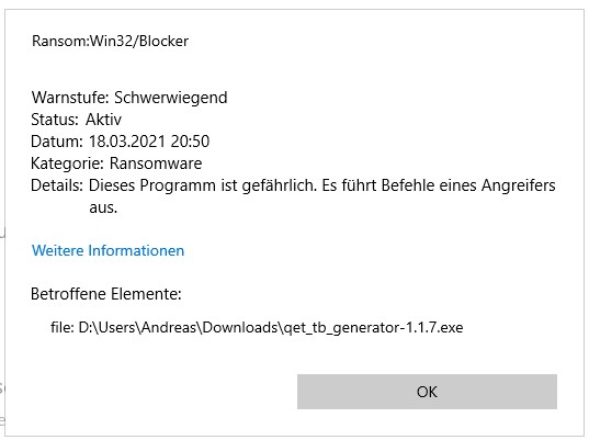

Next problem: Windows Defender marks qet_tb_generator-1.1.7.exe as malware win32/blocker.
https://www.virustotal.com/gui/file/dc6 … /detection
Maybe it is a false positive an reason why i can't start qet_tb_generator.
I've send to Microsoft Malware Submission.

17 (edited by RedBaron 2021-03-19 07:32:15)
Re: Klemmenplan-Plugin kann nicht gestartet werden-TB Plugin can´t started
Hello in Microsoft Windows 10 Defender the signature for qet_tb_generator 1.1.7.exe has been adjusted. The false detection has been removed.
Submission details Refresh
Submission ID: f17c5e16-6468-4432-a994-79b6291e086d
Status: Completed
Submitted by: RedBaron
Submitted: Mar 18, 2021 22:06:28
User Opinion: Incorrect detection
Analyst comments:
                We have removed the detection.  Please follow the steps below to clear cached detection and obtain the latest malware definitions.
     1. Open command prompt as administrator and change directory to c:\Program Files\Windows Defender
     2. Run “MpCmdRun.exe -removedefinitions -dynamicsignatures”
     3. Run "MpCmdRun.exe -SignatureUpdate"
Alternatively, the latest definition is available for download here: https://www.microsoft.com/en-us/wdsi/definitions
Thank you for contacting Microsoft.

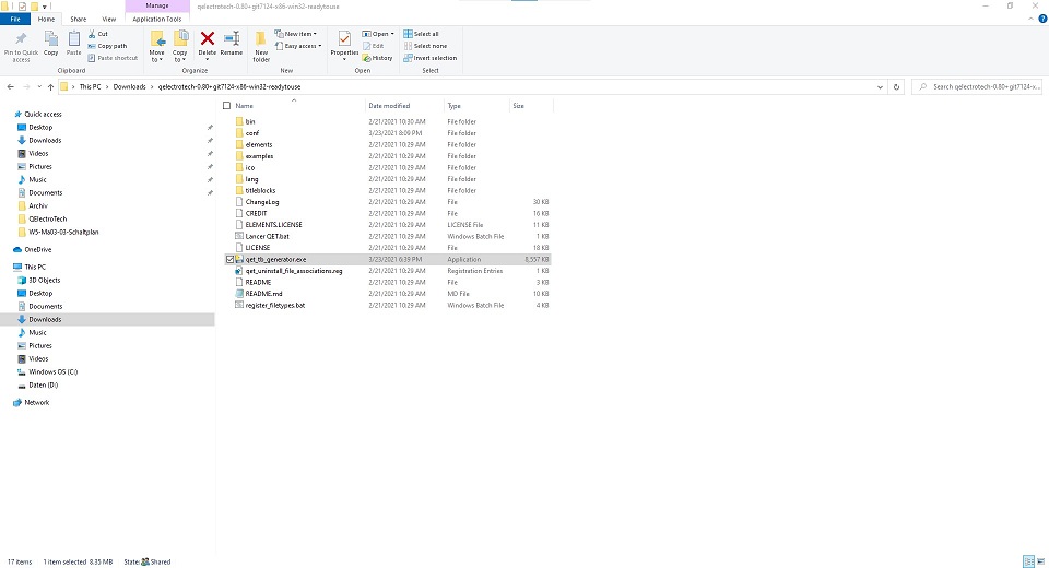

Tried with the Ready to Use Version of QElectroTech, no success.
The same happens with administrator rights, other user accounts and other computers.
Maybe a misconfigured Windows Installation?
Autodesk Inventor, Fusion 360 and SolidEdge run without problems.

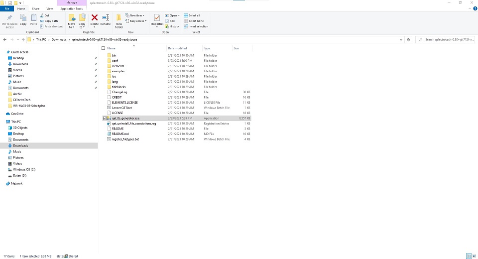

You put qet_tb_generator.exe inside your Readytouse directory?
https://github.com/qelectrotech/qelectr … .cpp#L2336
21 (edited by RedBaron 2021-03-23 21:26:56)
Yes as described above.

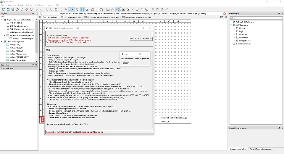

Screenshot 2021-03-23 202226.jpg, 64.34 kb, 960 x 520
22 (edited by RedBaron 2021-03-24 09:49:23)

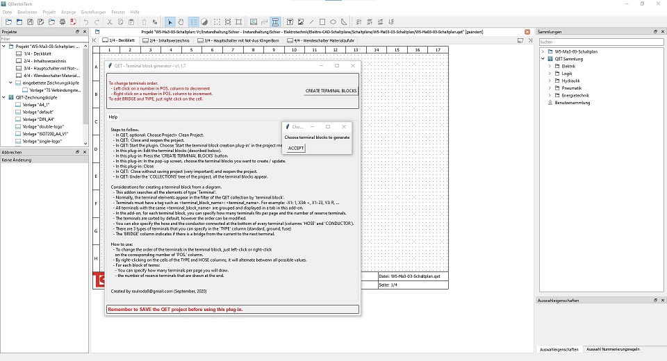

The terminal generator starts in V 0.8 Ready to Use after changing the language to English. The following windows are displayed: "Choose terminal Blocks to generate".
Screenshot 2021-03-24 083732.jpg, 147.53 kb, 960 x 520

Tried here but with 0.9-dev ReadyToUse and switched to german language, qet_tb_generator.exe start..
