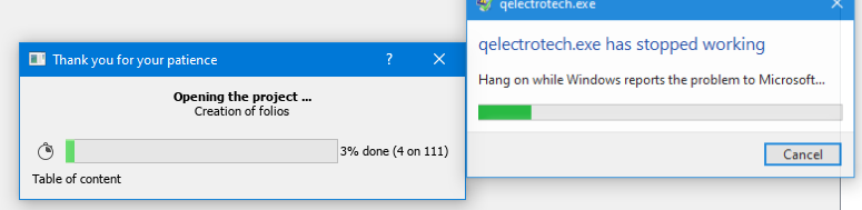

Good day, experiencing some crashes then loading a project, not sure how to collect good debug log, found only one in qet temp dir. Windows event log doesn't show anything useful.
Last page processed in qet before crash is "Table of content". It is probably crashing on next page.

Re: Crash on loading project
Maybe its pages? I do not have 111 page in project.
crash.png, 26.94 kb, 775 x 189
you have something there,
Fatal: ASSERT failure in QList<T>::at: "index out of range"
usually a "for loop" somewhere that is out of range
when loading sheet 4?

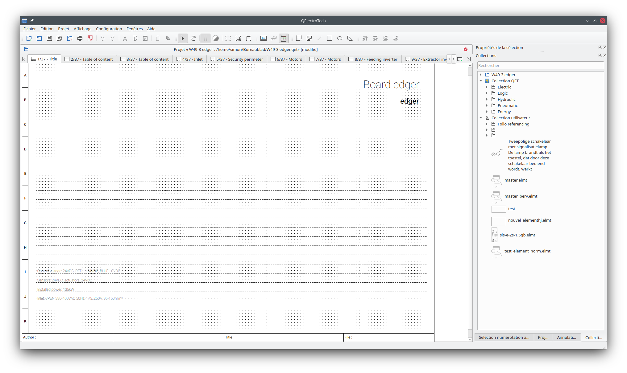

I project there was title, 2 table of content pages, and 4'th page circuit, not sure how its possible to create a for loop designing? Maybe wire loop?
8 (edited by De-Backer 2021-03-03 20:37:48)
I will test it => ok
Screenshot_20210303_193701.png, 166.58 kb, 2032 x 1210
9 (edited by De-Backer 2021-03-03 20:43:48)
mod nr 4
now we know what, now how.

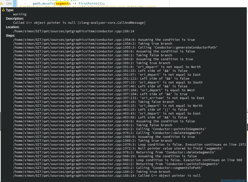

at
https://git.tuxfamily.org/qet/qet.git/t … .cpp#n1409
for (auto cond    : qAsConst(added_conductors)) added_items << cond;
testing
nop "The program has unexpectedly finished." nomicons/unsure

clang-Tidy and Clazy warn me about this
Screenshot_20210303_212210.png, 307.2 kb, 1021 x 750

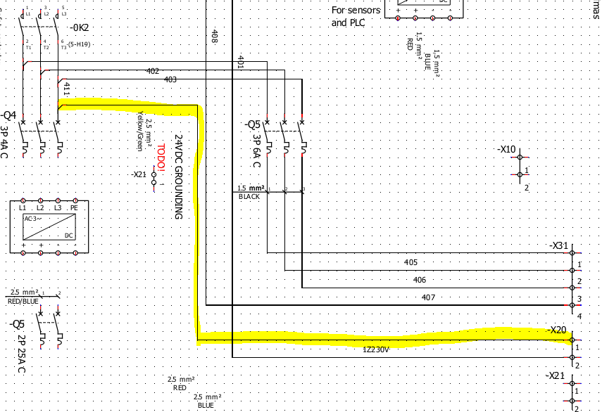

If it helps. One end was a splice, other terminal.
