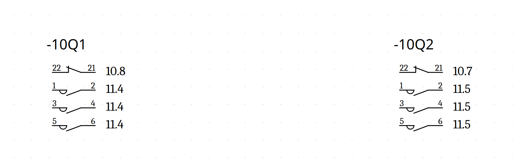

still got the same problem that there are only 1 & 3.
Fixed your 3 contacts was simple not power.

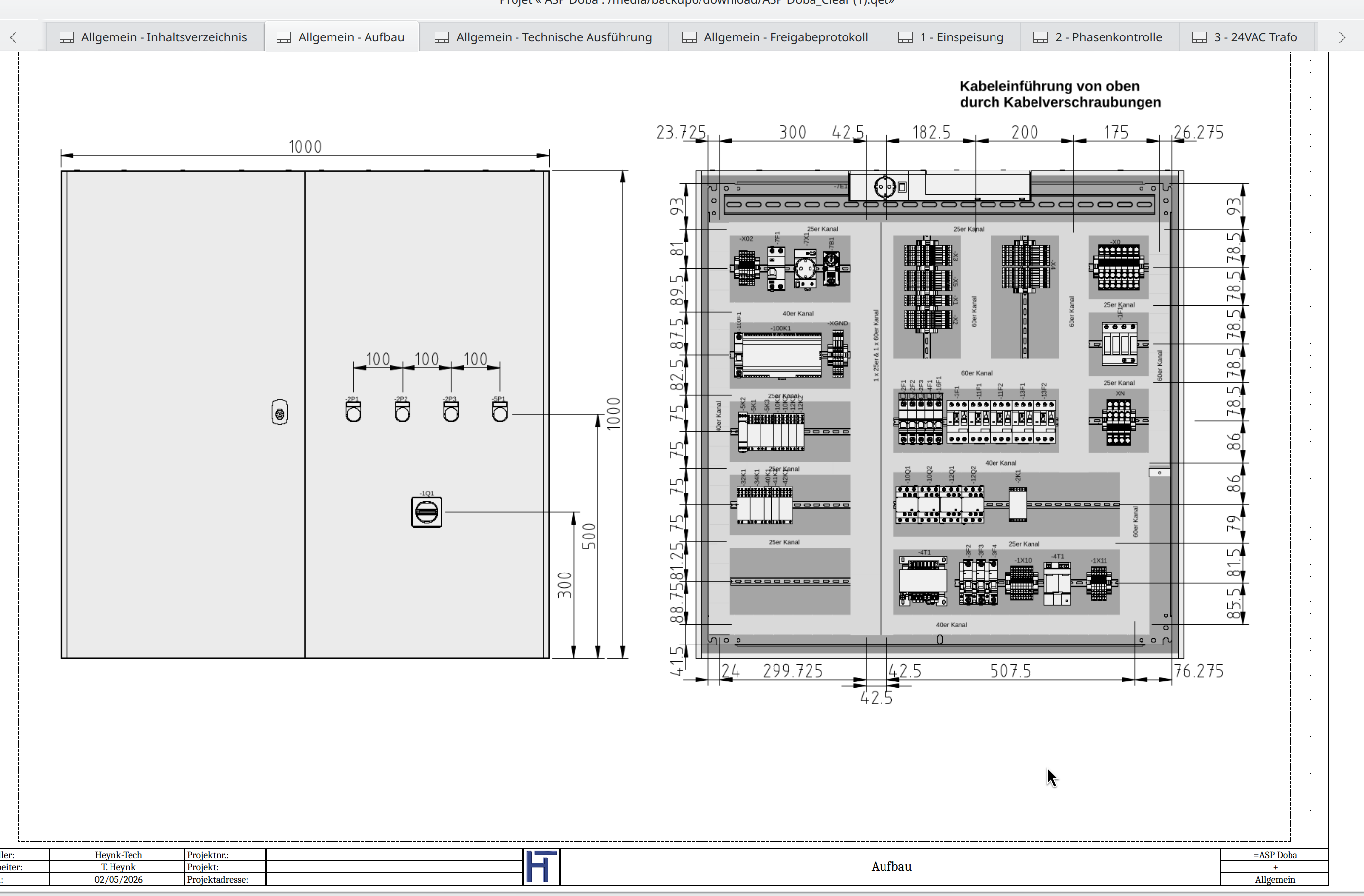

BTW, I love your cabinet page, very nice.
You use QET for this?
ahhhh. Thanks a lot Laurent!!!
No i made it with QCad. I want to have a real Scale.

I aggree with Laurent, your cabinet layout, as well as the entire schematic, look fantastic. As for the terminal and cable lists—did you draw all of those by hand?
