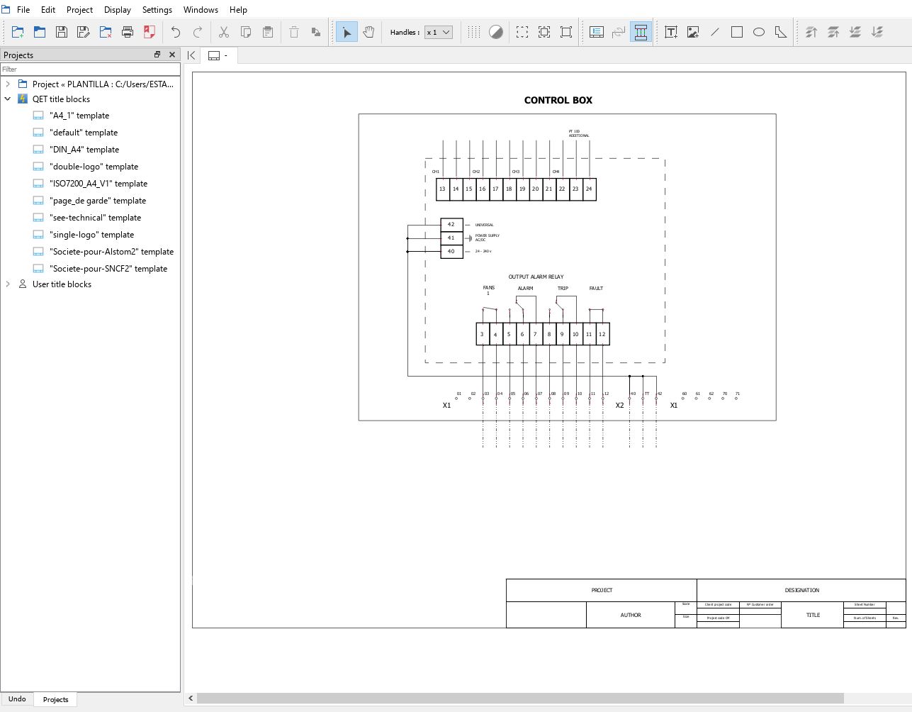

Like your screen -> project is open in diagram editor and printer icon is not grayed out.

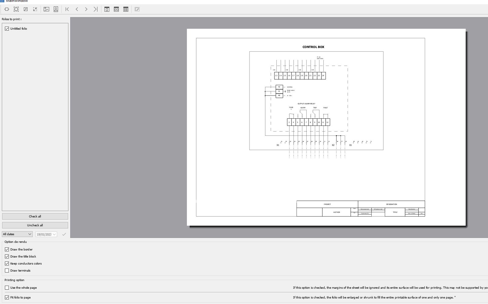

Sorry...but i still have a problem. Even when i put all the parameters the scheme does not adjust to the folio. And i do not know why.
thanks for your time.

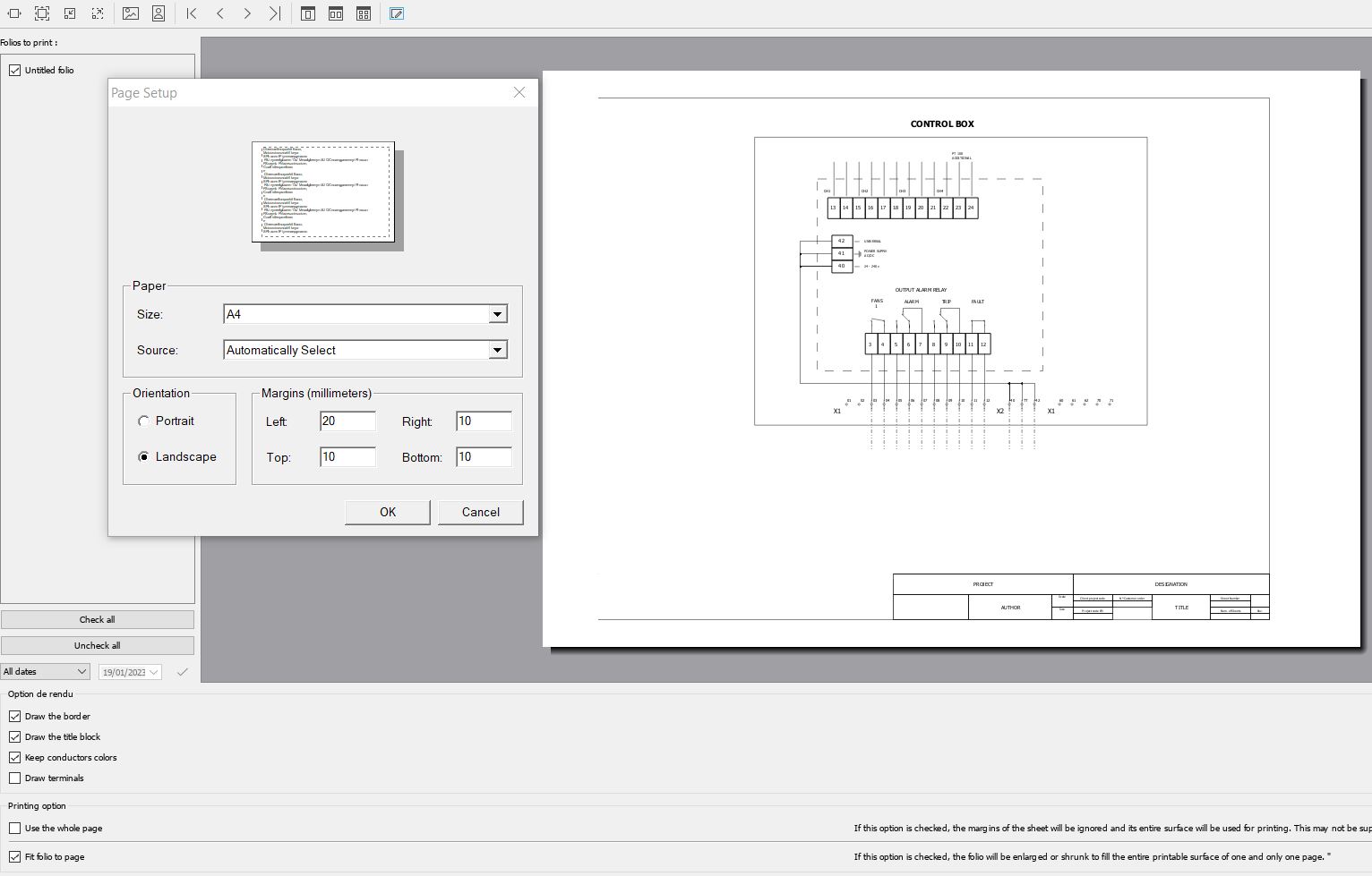

Try checkbox print options in layout.
I don't know where to find the checkbox print. Can you send me a caption?

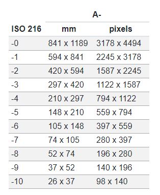

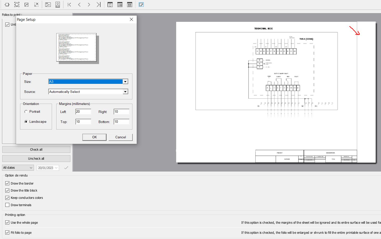

Keep coming out like this. It does not respect the margins I put in the page layout. Even if I have put the dimensions of the sheet of my design scheme the correct ones according to ISO 216:
The pixels dimensions according ISO 216

What is seen in the preview window is what will be printed and will not depend on the paper size, it will be the same if you want to print in A4 or A3 what you see on the screen will be represented as is whatever the sheet size.
Some old developers pulled their hair out or even almost threw their printers away because it's so complicated depending on the operating system, the printer driver or the brand of printer, for respect margin used by printer dialog..
