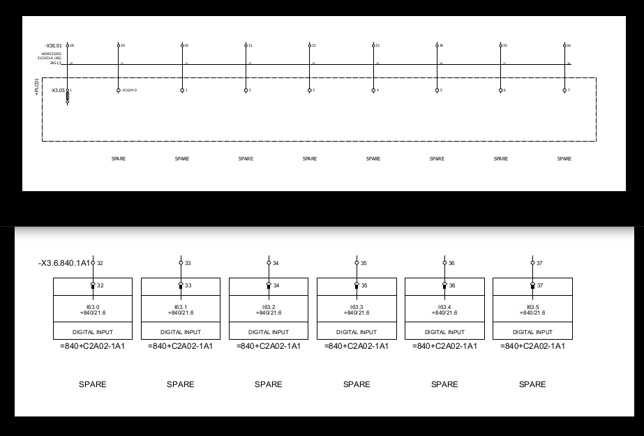

Related to the signal list and export signals to csv, I have not found any work made at this moment. Some representations of signals that I am use to read can be found at the image attached. Some of them can be found at PLC manufacturer (ex.: Siemens) webpage. The element editor allows creating this type of representation, the actual problem is to manage the elements as other CAE tools.
My question/proposal is if QElectroTech could have some elements type more. I propose to have at least the card and signal element. A card would be a group of signals. Adding this two elements more, once the user creates/export a nomenclature filtering with signals elements would create a list of signals from the single signals added plus the signals from each card added. Additionally a list of cards could also be done separated.

signals-representation.png, 21.56 kb, 923 x 625

It's already planned to add this new type of element.
Thanks for all details, they will help us to improve this features
