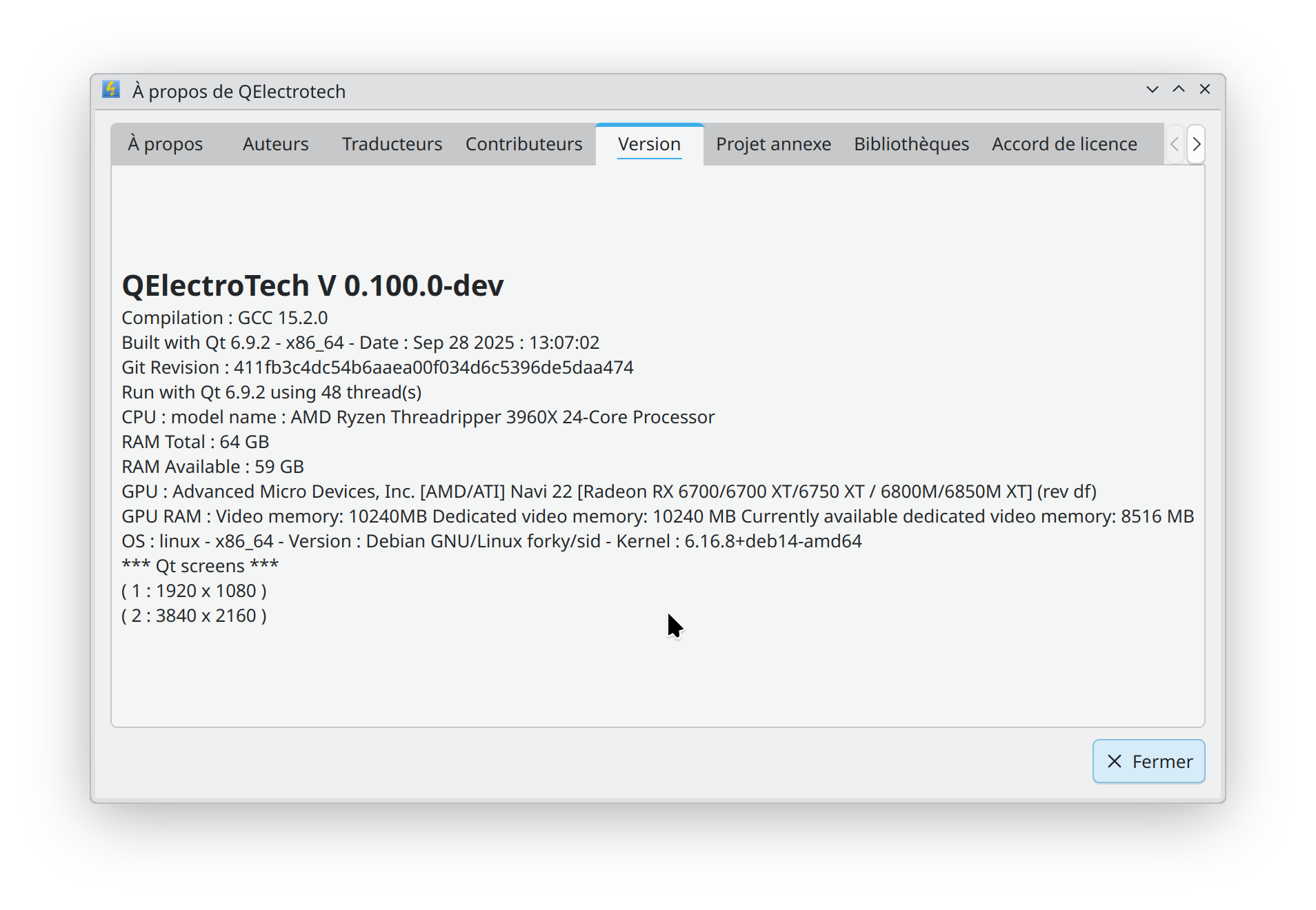

Re: Qt 6.0 development and qelectrotech
git clone --recursive https://github.com/qelectrotech/qelectrotech-source-mirror.git
cd qelectrotech-source-mirror/
git switch qt6-cmake
comment line 137 of /sources/machine_info.cpp to compile.
mkdir build && cd build
cmake .. -G Ninja -DBUILD_WITH_QT6=ON
time ninja -j48
Ignored 95 untranslated source text(s)
[318/478] Building CXX object CMakeFiles/qelectrotech.dir/sources/editor/UndoCommand/openelmtcommand.cpp.o
/media/backup6/qelectrotech-source-mirror/sources/editor/UndoCommand/openelmtcommand.cpp: In member function ‘virtual void OpenElmtCommand::redo()’:
/media/backup6/qelectrotech-source-mirror/sources/editor/UndoCommand/openelmtcommand.cpp:66:102: note: ‘#pragma message: @TODO uncommante slot_select when fixed, see itemChange function for each primitive’
   66 | #pragma message("@TODO uncommante slot_select when fixed, see itemChange function for each primitive")
[478/478] Linking CXX executable qelectrotech
real    0m36,019s
user    21m37,065s
sys     1m39,485s
QElectroTech V 0.100.0-dev
Compilation : GCC 15.2.0
Built with Qt 6.9.2 - x86_64 - Date : Sep 28 2025 : 12:58:45
Git Revision : 411fb3c4dc54b6aaea00f034d6c5396de5daa474
Run with Qt 6.9.2 using 48 thread(s)
https://download.qelectrotech.org/qet/forum_img_2/Qt6_test_build.png

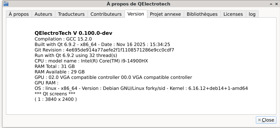

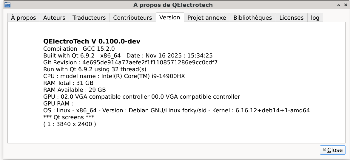

@ scorpio810
@ plc-user
I have also an faster computer,but i use it not for compiling the source.
I have it one year and one month.MSI Raider 18HXA14VGG
Your computers compiling to fast that you not see the errors and the warings.
errors
missing #include <QUuid>
../sources/qetxml.h  = add #include <QUuid> on line 23 after QPen on line 22
../sources/titleblocktemplate.cpp
missing bool on line 106
now on line 106
bool xml_parsing (bool)xml_doc.setContent(&template_file);
../sources/titleblock/templatescollection.cpp
missing bool on  line 457
now on line 457
bool xml_parsing = (bool)xml_document -> setContent(&xml_file);
