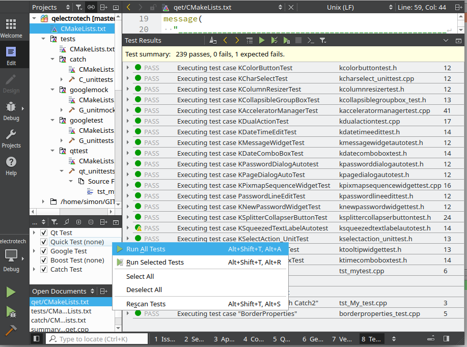

I ran the Clang-Tidy tool on qet ... umm there are still a lot of improvements to be done.
Adding
// NOLINT
will also be needed in the code
suppressing undesired diagnostics
extra info

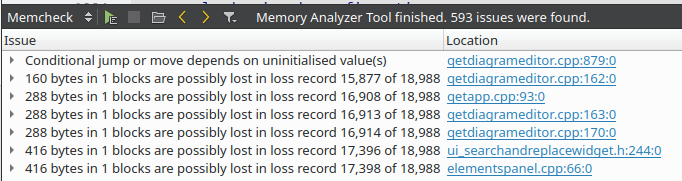

Memcheck also makes some comments.
Screenshot_20201015_225511.png, 65.66 kb, 682 x 181

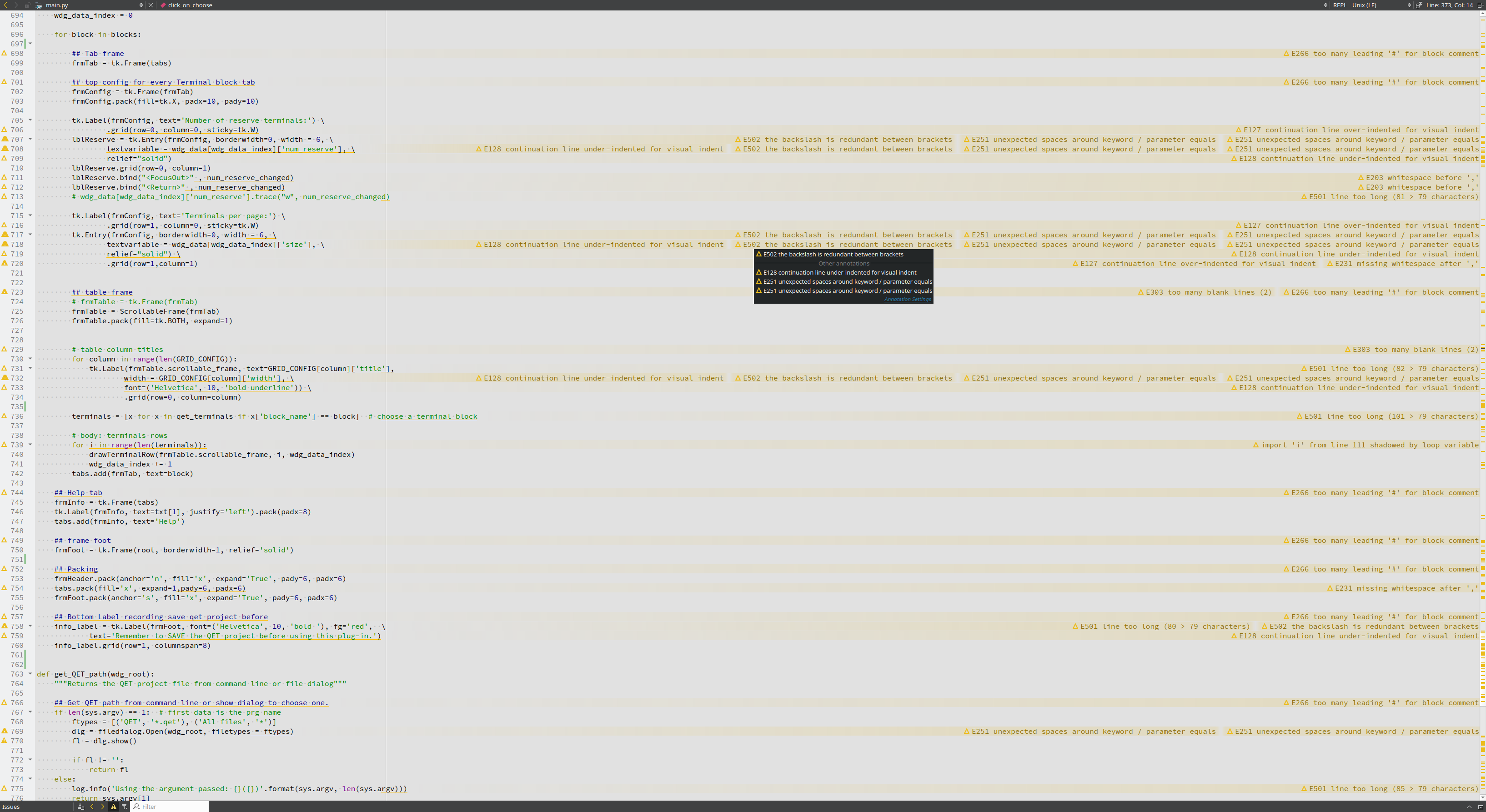

Re: Qt 6.0 development and qelectrotech
i am considering rewriting qet_tb_generator in C ++, just too many warnings

19:46:18: Running steps for project qelectrotech...
19:46:18: Starting: "/home/simon/Qt/Tools/CMake/bin/cmake" --build . --target all
[1/298 0.5/sec] Building CXX object Tests/tests/CMakeFiles/My_test.dir/tst_My_test.cpp.o
[2/298 0.9/sec] Building CXX object Tests/tests/CMakeFiles/My_test.dir/__/__/sources/borderproperties.cpp.o
[3/298 0.8/sec] Automatic MOC and UIC for target qelectrotech
[4/298 1.0/sec] Generating ui_projectprintwindow.h
FAILED: sources/ui_projectprintwindow.h
cd /home/simon/GIT/build/qet-Desktop_Qt_5_15_1_GCC_64bit-Debug/sources && /home/simon/Qt/5.15.1/gcc_64/bin/uic -o /home/simon/GIT/build/qet-Desktop_Qt_5_15_1_GCC_64bit-Debug/sources/ui_projectprintwindow.h /home/simon/GIT/qet/sources/print/projectprintwindow.h
uic: Error in line 1, column 1 : Start tag expected.
for Cmake
Running /home/simon/Qt/Tools/CMake/bin/cmake -S /home/simon/GIT/qet -B /home/simon/GIT/build/qet-Desktop_Qt_5_15_1_GCC_64bit-Debug in /home/simon/GIT/build/qet-Desktop_Qt_5_15_1_GCC_64bit-Debug.
_____________________________________________________________________
Copyright 2006 The QElectroTech Team
This file is part of QElectroTech.
QElectroTech is free software: you can redistribute it and/or modify
it under the terms of the GNU General Public License as published by
the Free Software Foundation, either version 2 of the License, or
(at your option) any later version.
QElectroTech is distributed in the hope that it will be useful,
but WITHOUT ANY WARRANTY; without even the implied warranty of
MERCHANTABILITY or FITNESS FOR A PARTICULAR PURPOSE.  See the
GNU General Public License for more details.
You should have received a copy of the GNU General Public License
along with QElectroTech.  If not, see <http://www.gnu.org/licenses/>.
PROJECT_NAME       :qelectrotech
PROJECT_SOURCE_DIR :/home/simon/GIT/qet
QET_DIR            :/home/simon/GIT/qet
GIT_COMMIT_SHA     :d0c129478ec16aa869270444a90957ad305ff1b9
Installing in /usr. Run /home/simon/GIT/build/qet-Desktop_Qt_5_15_1_GCC_64bit-Debug/_deps/kwidgetsaddons-build/prefix.sh to set the environment for qelectrotech.
-- At least one python version must be available to use PythonModuleGeneration.
-- The following features have been enabled:
 * DESIGNERPLUGIN, Build plugin for Qt Designer
-- The following OPTIONAL packages have been found:
 * KF5CoreAddons
-- The following REQUIRED packages have been found:
 * ECM (required version >= 5.76.0), Extra CMake Modules., <https://commits.kde.org/extra-cmake-modules>
 * Qt5Gui (required version >= 5.15.1)
 * Qt5Widgets
 * Qt5LinguistTools
 * Qt5UiPlugin
   Required to build Qt Designer plugins
 * Qt5Test
 * Qt5 (required version >= 5.12.0)
-- The following features have been disabled:
 * QCH, API documentation in QCH format (for e.g. Qt Assistant, Qt Creator & KDevelop)
-- The following OPTIONAL packages have not been found:
 * PythonModuleGeneration
QET_COMPONENTS     :WidgetsConcurrentXmlSvgNetworkSqlPrintSupportLinguistTools
QT_VERSION_MAJOR   :5
Add sub directorie tests
.____________________________________________________________________
. PROJECT_NAME:       unittests
. PROJECT_SOURCE_DIR: /home/simon/GIT/qet/tests
. Add sub directorie catch
..___________________________________________________________________
.. PROJECT_NAME       :C_unittests
.. PROJECT_SOURCE_DIR :/home/simon/GIT/qet/tests/catch
.. QET_DIR            :/home/simon/GIT/qet
.. QT_VERSION_MAJOR   :5
.. CATCH_INCLUDE_DIR is not set,assuming Catch2 can be found automatically in your system
. Add sub directorie googletest
.. PROJECT_NAME       :G_unittests
.. PROJECT_SOURCE_DIR :/home/simon/GIT/qet/tests/googletest
. Add sub directorie googlemock
.. PROJECT_NAME       :G_unitmocktests
.. PROJECT_SOURCE_DIR :/home/simon/GIT/qet/tests/googlemock
. Add sub directorie qttest
.. PROJECT_NAME       :qt_unittests
.. PROJECT_SOURCE_DIR :/home/simon/GIT/qet/tests/qttest
-- Configuring done
-- Generating done
-- Build files have been written to: /home/simon/GIT/build/qet-Desktop_Qt_5_15_1_GCC_64bit-Debug
Elapsed time: 00:01.
compilation
13:30:06: Running steps for project qelectrotech...
13:30:07: Starting: "/home/simon/Qt/Tools/CMake/bin/cmake" --build . --target all
[1/33 189.3/sec] Automatic MOC and UIC for target gtest
[2/33 369.5/sec] Automatic MOC and UIC for target C_unittests
[3/33 162.3/sec] Building CXX object tests/catch/CMakeFiles/C_unittests.dir/C_unittests_autogen/mocs_compilation.cpp.o
[4/33 210.0/sec] Building CXX object _deps/gtest-build/googletest/CMakeFiles/gtest.dir/gtest_autogen/mocs_compilation.cpp.o
[5/33 34.4/sec] Linking CXX shared library lib/libgtestd.so
[6/33 40.1/sec] Automatic MOC and UIC for target gmock
[7/33 46.7/sec] Automatic MOC and UIC for target gtest_main
[8/33 49.8/sec] Building CXX object _deps/gtest-build/googletest/CMakeFiles/gtest_main.dir/gtest_main_autogen/mocs_compilation.cpp.o
[9/33 55.5/sec] Building CXX object _deps/gtest-build/googlemock/CMakeFiles/gmock.dir/gmock_autogen/mocs_compilation.cpp.o
[10/33 55.9/sec] Automatic MOC and UIC for target qt_unittests
[11/33 58.3/sec] Building CXX object tests/qttest/CMakeFiles/qt_unittests.dir/qt_unittests_autogen/mocs_compilation.cpp.o
[12/33 53.7/sec] Linking CXX shared library lib/libgtest_maind.so
[13/33 57.1/sec] Automatic MOC and UIC for target G_unittests
[14/33 58.3/sec] Building CXX object tests/googletest/CMakeFiles/G_unittests.dir/G_unittests_autogen/mocs_compilation.cpp.o
[15/33 57.6/sec] Linking CXX shared library lib/libgmockd.so
[16/33 60.6/sec] Automatic MOC and UIC for target gmock_main
[17/33 62.2/sec] Building CXX object _deps/gtest-build/googlemock/CMakeFiles/gmock_main.dir/gmock_main_autogen/mocs_compilation.cpp.o
[18/33 51.3/sec] Linking CXX shared library lib/libgmock_maind.so
[19/33 53.6/sec] Automatic MOC and UIC for target G_unitmocktests
[20/33 54.4/sec] Building CXX object tests/googlemock/CMakeFiles/G_unitmocktests.dir/G_unitmocktests_autogen/mocs_compilation.cpp.o
[21/33 39.7/sec] Building CXX object tests/catch/CMakeFiles/C_unittests.dir/tst_My_test.cpp.o
[22/33 15.7/sec] Building CXX object tests/googletest/CMakeFiles/G_unittests.dir/main.cpp.o
[23/33 15.4/sec] Building CXX object tests/catch/CMakeFiles/C_unittests.dir/__/__/sources/borderproperties.cpp.o
[24/33 13.9/sec] Building CXX object tests/catch/CMakeFiles/C_unittests.dir/src/borderproperties_test.cpp.o
[25/33 14.3/sec] Building CXX object tests/googlemock/CMakeFiles/G_unitmocktests.dir/main.cpp.o
[26/33 12.3/sec] Building CXX object tests/qttest/CMakeFiles/qt_unittests.dir/tst_mytest.cpp.o
[27/33 11.2/sec] Building CXX object tests/googletest/CMakeFiles/G_unittests.dir/tst_My_test.cpp.o
[28/33 11.4/sec] Linking CXX executable tests/qttest/qt_unittests
[29/33 10.7/sec] Building CXX object tests/googlemock/CMakeFiles/G_unitmocktests.dir/tst_My_test.cpp.o
[30/33 11.0/sec] Linking CXX executable tests/googletest/G_unittests
[31/33 10.2/sec] Linking CXX executable tests/googlemock/G_unitmocktests
[32/33 4.4/sec] Building CXX object tests/catch/CMakeFiles/C_unittests.dir/main.cpp.o
[33/33 4.3/sec] Linking CXX executable tests/catch/C_unittests
13:30:14: The process "/home/simon/Qt/Tools/CMake/bin/cmake" exited normally.
13:30:14: Elapsed time: 00:08.
Test
PASS    Executing test case mytest
    Qt version: 5.15.1
    Qt build: Qt 5.15.1 (x86_64-little_endian-lp64 shared (dynamic) release build; by GCC 5.3.1 20160406 (Red Hat 5.3.1-6))
    QTest version: 5.15.1
PASS    Executing test function initTestCase
INFO    Signal: QThread(00bcad80) started ()
PASS    mytest::initTestCase
    Execution took 0.171962 ms.
PASS    Executing test function test_case1
PASS    mytest::test_case1
    Execution took 0.01823 ms.
PASS    Executing test function cleanupTestCase
PASS    mytest::cleanupTestCase
    Execution took 0.00264 ms.
INFO    Signal: QThread(00bcad80) finished ()
    Test execution took 0.297252 ms.
    Note: Google Test filter = googletest.*
PASS    Executing test suite googletest
PASS    googletest.sample_test
    Execution took 0 ms.
    Test execution took 0 ms total
    Note: Google Test filter = googlemocktest.*
PASS    Executing test suite googlemocktest
PASS    googlemocktest.sample_mock
PASS    Executing test case "My first test with Catch2"
PASS    Test case "My first test with Catch2" passed
    Finished executing test case "My first test with Catch2"
PASS    Executing test case "BorderProperties"
PASS    Test case "BorderProperties" passed
    Finished executing test case "BorderProperties"
ToDo: build qelectrotech

now the Tests works the builds are disabled
you can already try them
the intention is to have K5 packages when building
the problems are with the .ui files
therefore the builds are disabled
