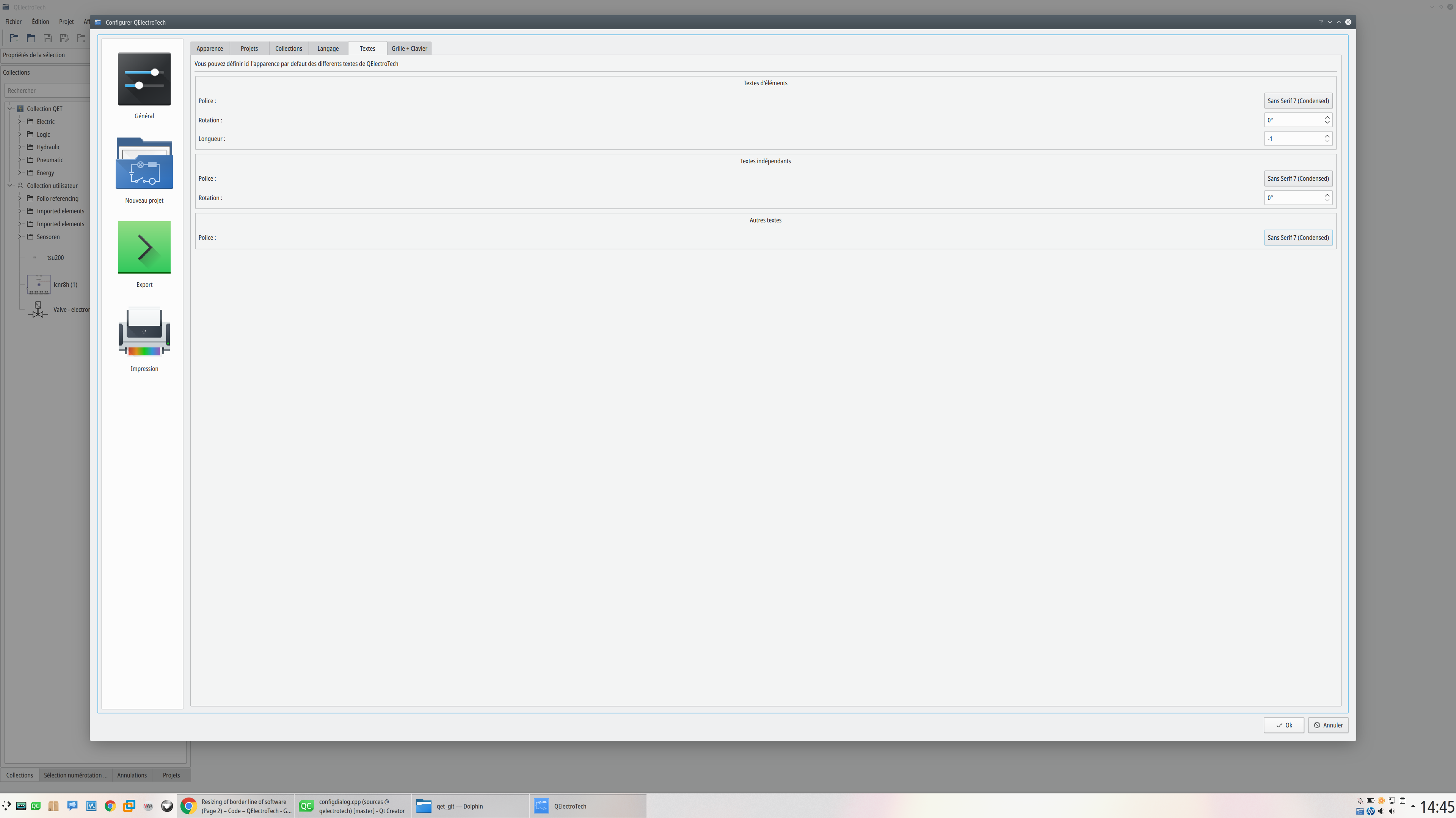

Re: Resizing of border line of software
this i have
    Constructeur
    @param parent QWidget parent
ConfigDialog::ConfigDialog(QWidget *parent) : QDialog(parent) {
    // liste des pages
    pages_list = new QListWidget();
    pages_list -> setViewMode(QListView::IconMode);
    pages_list -> setIconSize(QSize(128, 128));
    pages_list -> setMovement(QListView::Static);
    pages_list -> setMinimumWidth(168);
    pages_list -> setMaximumWidth(168);
    pages_list -> setSpacing(16);
    pages_list -> setHorizontalScrollBarPolicy(Qt::ScrollBarAlwaysOff);
    // pages
    pages_widget = new QStackedWidget();
    // boutons
    buttons = new QDialogButtonBox(
                QDialogButtonBox::Ok
                |QDialogButtonBox::Cancel);
    QScrollArea *scroll = new QScrollArea(this);
    scroll->setHorizontalScrollBarPolicy(Qt::ScrollBarAlwaysOn);
    scroll->setVerticalScrollBarPolicy(Qt::ScrollBarAlwaysOn);
    QWidget *viewport = new QWidget(this);
    scroll->setWidget(viewport);
    scroll->setWidgetResizable(true);
    // layouts
    QHBoxLayout *hlayout1 = new QHBoxLayout(viewport);
    // add needed widgets to layout "hlayout1"
    hlayout1 -> addWidget(pages_list);
    hlayout1 -> addWidget(pages_widget);
    //add hlayout1 to widget
    viewport->setLayout(hlayout1);
    // Add a layout for QDialog
    QVBoxLayout *dialog_layout = new QVBoxLayout(this);
    dialog_layout->addWidget(scroll); // add scroll to the QDialog's layout
    dialog_layout -> addWidget(buttons);
    setLayout(dialog_layout);
    // connexion signaux / slots
    connect(buttons, SIGNAL(accepted()), this, SLOT(applyConf()));
    connect(buttons, SIGNAL(rejected()), this, SLOT(reject()));
    connect(pages_list, SIGNAL(currentRowChanged(int)),
        pages_widget, SLOT(setCurrentIndex(int)));
    Machine_info *mymachineinfo= new Machine_info(this);
    resize(mymachineinfo->get_max_screen_width(),
           mymachineinfo->get_max_screen_height());
#ifdef Q_OS_MACOS
    if (parent) {
        setWindowFlags(Qt::Sheet);
#endif
Screenshot_20200722_205059.png, 79.23 kb, 866 x 767

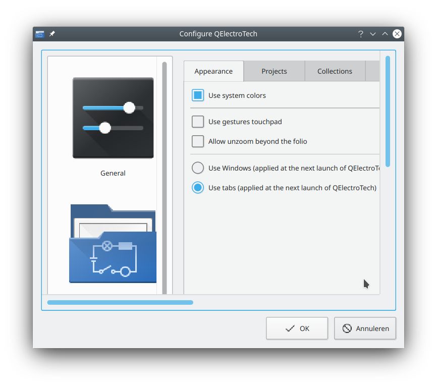

Tried on Win10 VM  3840x2160 screen the widget is so very big, widget button is always on taskbar..
Maybe this:
Attachment icon 0001-Improve-resize-i_max_screen_-to-config-dialog.patch 910 b, 368 downloads since 2020-07-25
47 (edited by De-Backer 2020-07-25 19:18:09)
just remove resize (..)
Edit
never mind, is even worse
ok for patch
48 (edited by De-Backer 2020-07-25 22:00:52)
Maybe this:
The only thing is that with all screens this is 2/3,
while at low reslousie screens this just becomes too small.
What do you think of this:
setMaximumSize(mymachineinfo->i_max_screen_width(),
               mymachineinfo->i_max_screen_height());
    resize(1400,1000);
Attachment icon 0001-Fix-widget-size.patch 891 b, 359 downloads since 2020-07-25
Is great on my UHD screen.
If you could merge it. ;-)
50 (edited by De-Backer 2020-07-25 22:09:24)
ok I'm still testing it on low reslousie screens ...
Screenshot_20200725_220855.png, 148.14 kb, 1666 x 1331
