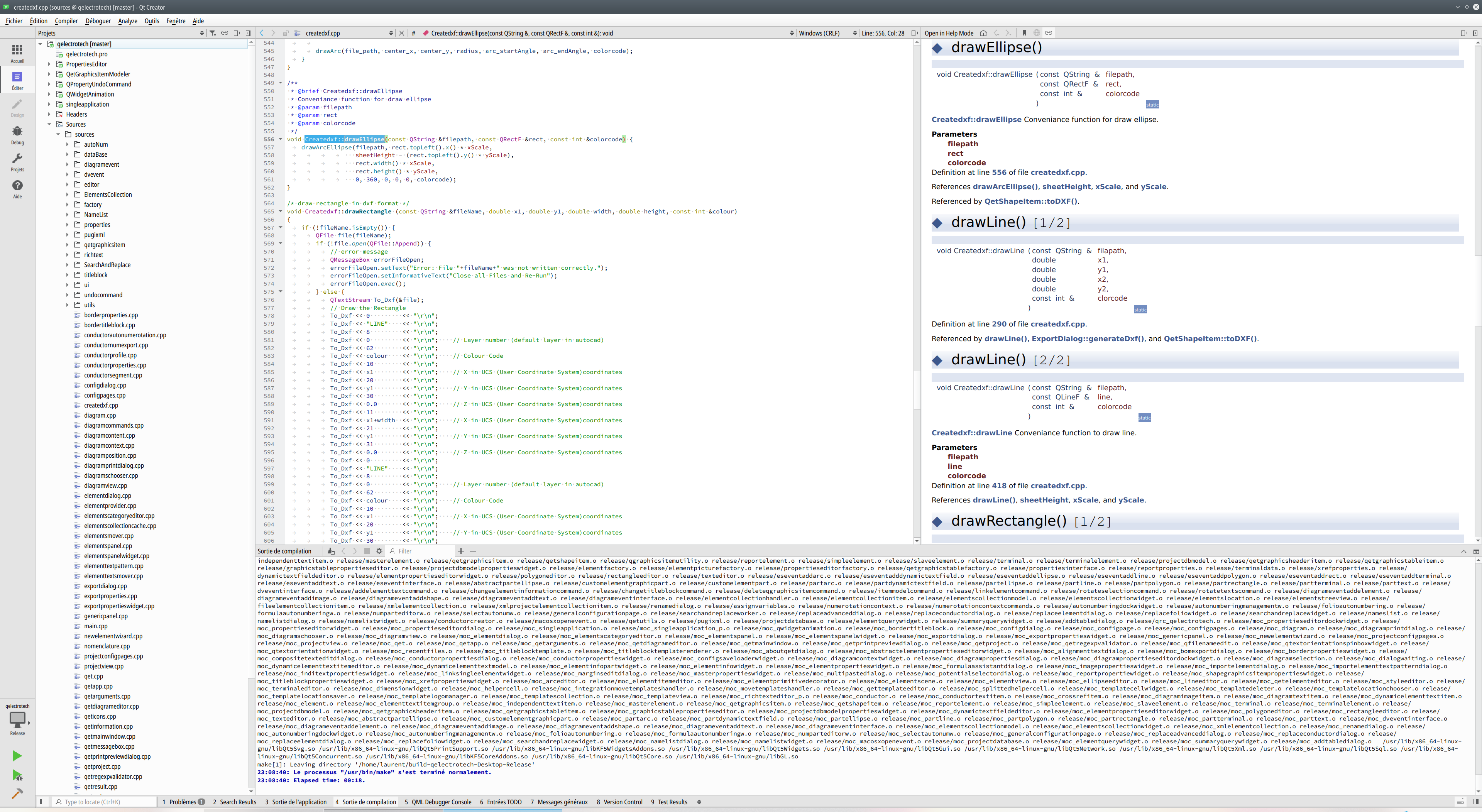

I got it working thanks
Screenshot_20200715_213746.png, 938.67 kb, 2012 x 2289

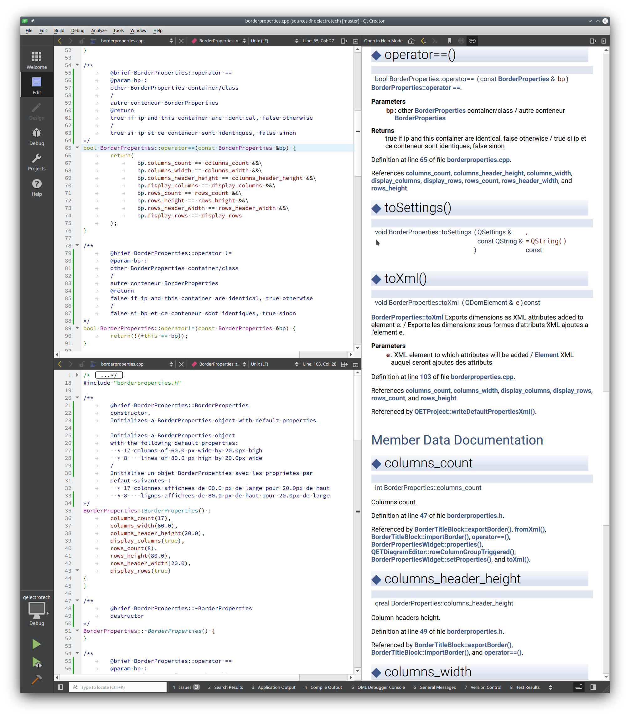

I now see better how it looks in doxygen
first test file/class
Attachment icon 0001-Mod-doc-for-better-readability-doxygen.patch 7.93 kb, 391 downloads since 2020-07-15

Update Doxyfile:
Please change STRIP_FROM_PATH to your source location and maybe QHG_LOCATION  path depending on your distrib.
run
doxygen Doxyfile
Now add QElectroTech.qch in qtcreator ->tools-> help like this to your doc folder "QHP_VIRTUAL_FOLDER "
https://www.sinax.be/images/doxygen-qt-creator/qtcreator-settings.png
No need to compile the plugin or qtcreator, we only need a recent qtcreator binary.
Enjoy !
Merged, thanks Simon.

Multilingual comment in code are great for all want to contribute.
