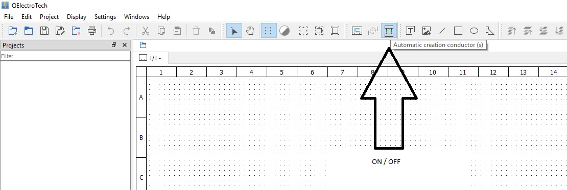

Re: Deactivate secondary colour between elements, auto connecting; crashes
Pingumann wrote:
2. Another irritating issue is that the elements connect with others elements automatically. Once elements are connected, the element should keep the connections with it, but not connect to other elements automatically on its own. The moment an element is moved, it connects with others automatically. This behaviour is erratic and not useful. Can it be de-activated?
