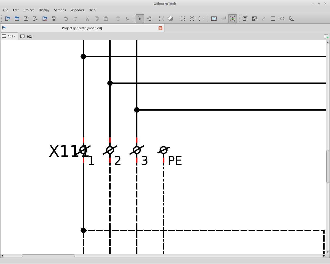

I really like this new function of dynamic texts. When using rotation I face some problems. When I make a "Group of texts" and put into it some texts with rotation, the rotation is neutralized. Is there some way of keeping the rotation in a group text without rotating the whole group? I would like to have both vertical and horizontal texts in the same group.
pic2.png, 86.31 kb, 745 x 1053
Re: Display texts
Re: Display texts

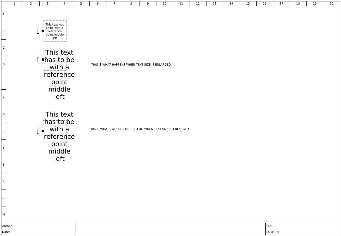

Thank you for this good new option. Wonderful. When using it I found a little bug when changing text size. See attachment.
1_diagram.png, 54.7 kb, 1430 x 990
Re: Display texts
Fixed, thanks for report
