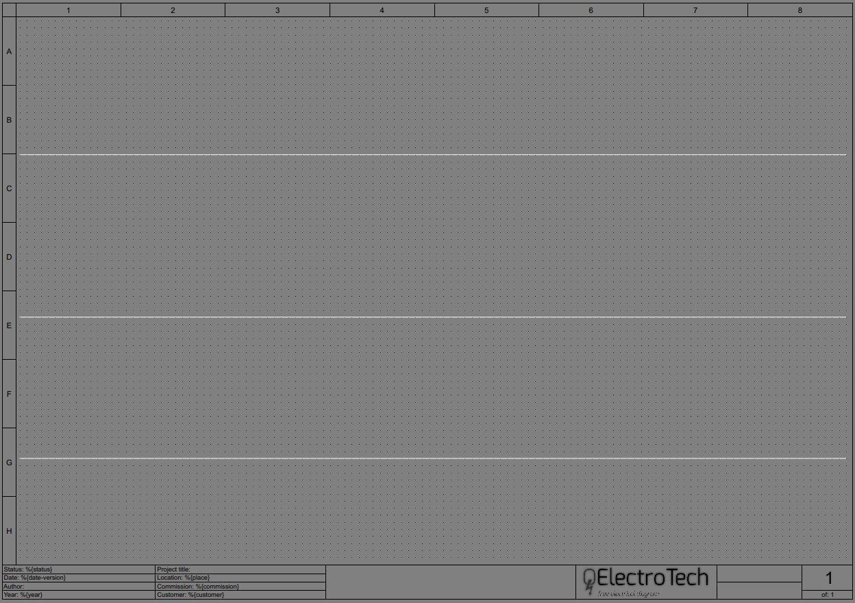

Hi Max,
you should try this:
- create a new folio.
- set the folio background to grey (button is in the upper tool bar)
- draw a horizontal line and set its color to white and lock its position
- repeat as much as you need!
When printing, you don't need to delete anything since the lines are white and only visible if you set the background to grey.
The result looks like this:
nuri-help-lines.png, 30.28 kb, 1248 x 880
