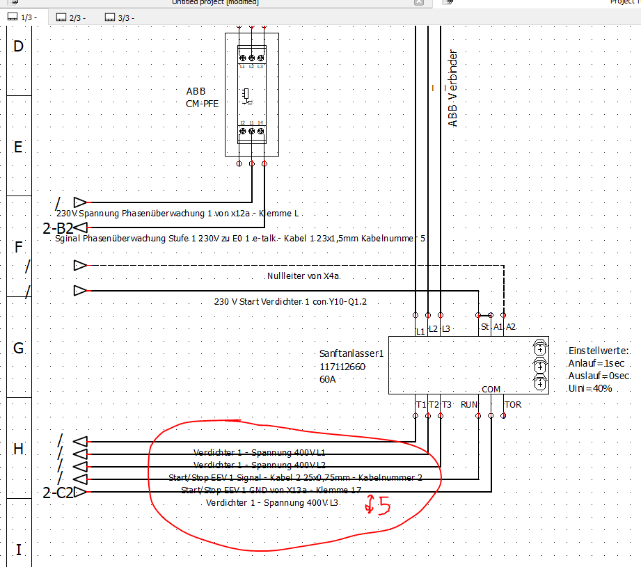

I have this problem when I am drawing my schematic. The minimum text size of the conductor multiline is 5 and it is not suitable for the minimum distance of the conductors. I need to draw schematics with a lot of connections, is it possible to change the minimum text size to 3 or 4?
Unbenannt.PNG, 48.81 kb, 921 x 815

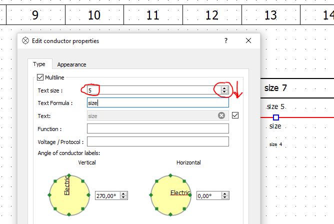

Re: Minimum text size
The point is that I cannot reduce text size from a conductor. If I creat a new text label it is possible, but then it is not linked with the conductor
Unbenannt2.PNG, 20.7 kb, 668 x 448
Here fonts rendering in 3, or 4 pt isn't very nice.
I build new packages, you can try it soon.
Thanks nomicons/wink
0.70-dev+svn5053 build and upload finished.
It's working, merci
