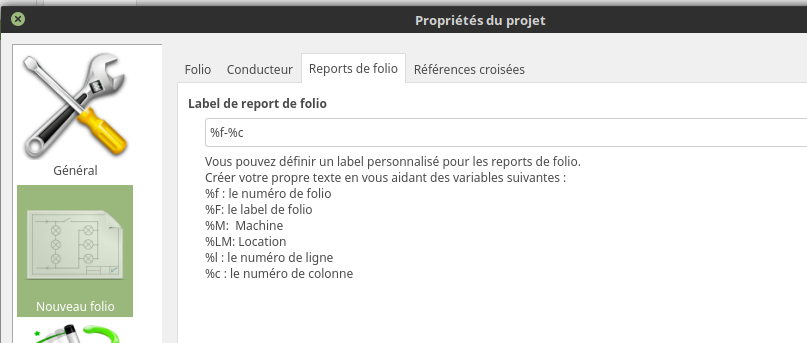

Re: Folio referencing - only by page ID?! "Use label instead of folio ID"
You have to change formula about report folio.
Project proterties/New folio and folio report:
on the fomula %f is id of folio and %F label of folio
Capture du 2017-08-11 20-11-02.png, 53.46 kb, 807 x 343
Merci, monsieur! Works perfectly!
