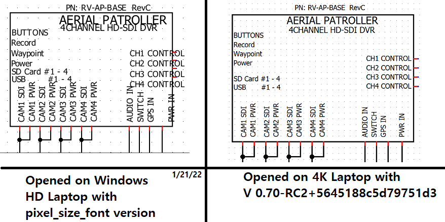

Thank you!  We tried it out and so far I can't see a difference in performance.
I took screen shots of a module in a drawing, as opened with v0.7 and with the new pixel_size_font build.
QET Dev Modules Text TEST 21Jan2022.png, 100.85 kb, 878 x 438

Hello, it's normal you can't see a difference because the test is wrong.
To test, you need to do these few steps :
-Install the qelectrotech pixel_size_font build on both computers (HD laptop and 4K laptop) and only use this qelectrotech version for the test.
-Create a new project in computer 1, save it and open it in computer 2.
-See the difference
-Create a new project in computer 2, save it and open it in computer 1.
-See the difference.
-Tell us if they work or not.
The test must be done ONLY in this way. If the text size is good, we can go further.
