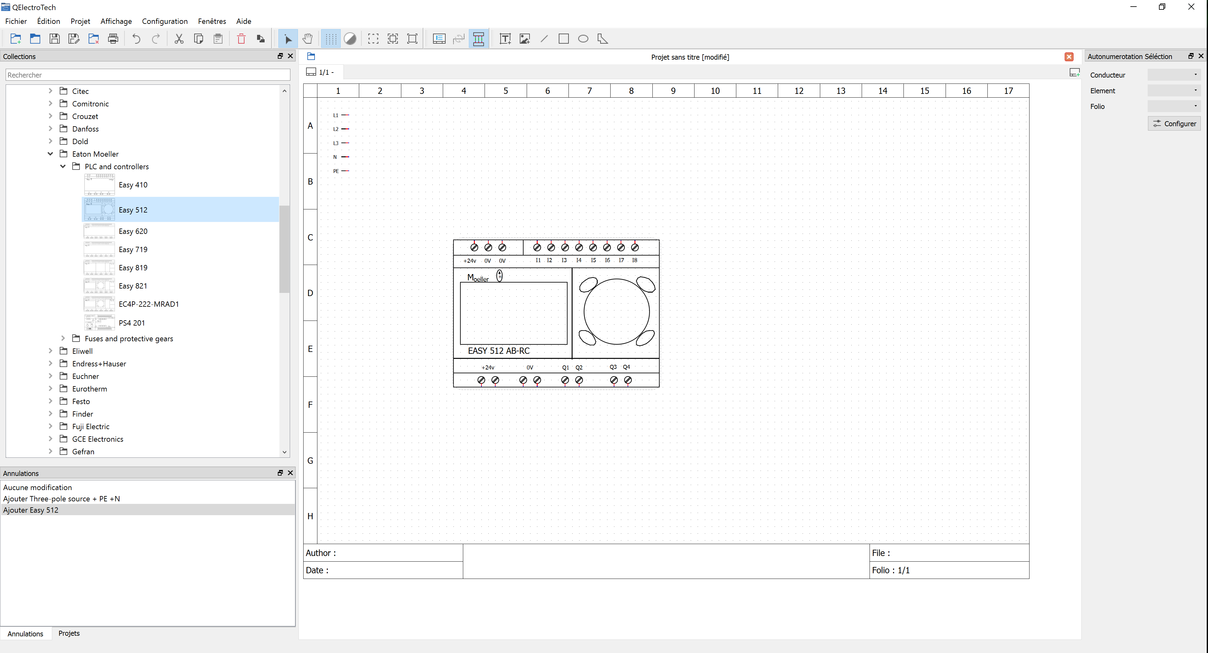

| Description | when using monitor scale example 200% at my monitor by default then text size too big because GUI not use fully the auto DPI for windows | ||||
| Attached Files | HiDPI.patch (759 bytes)

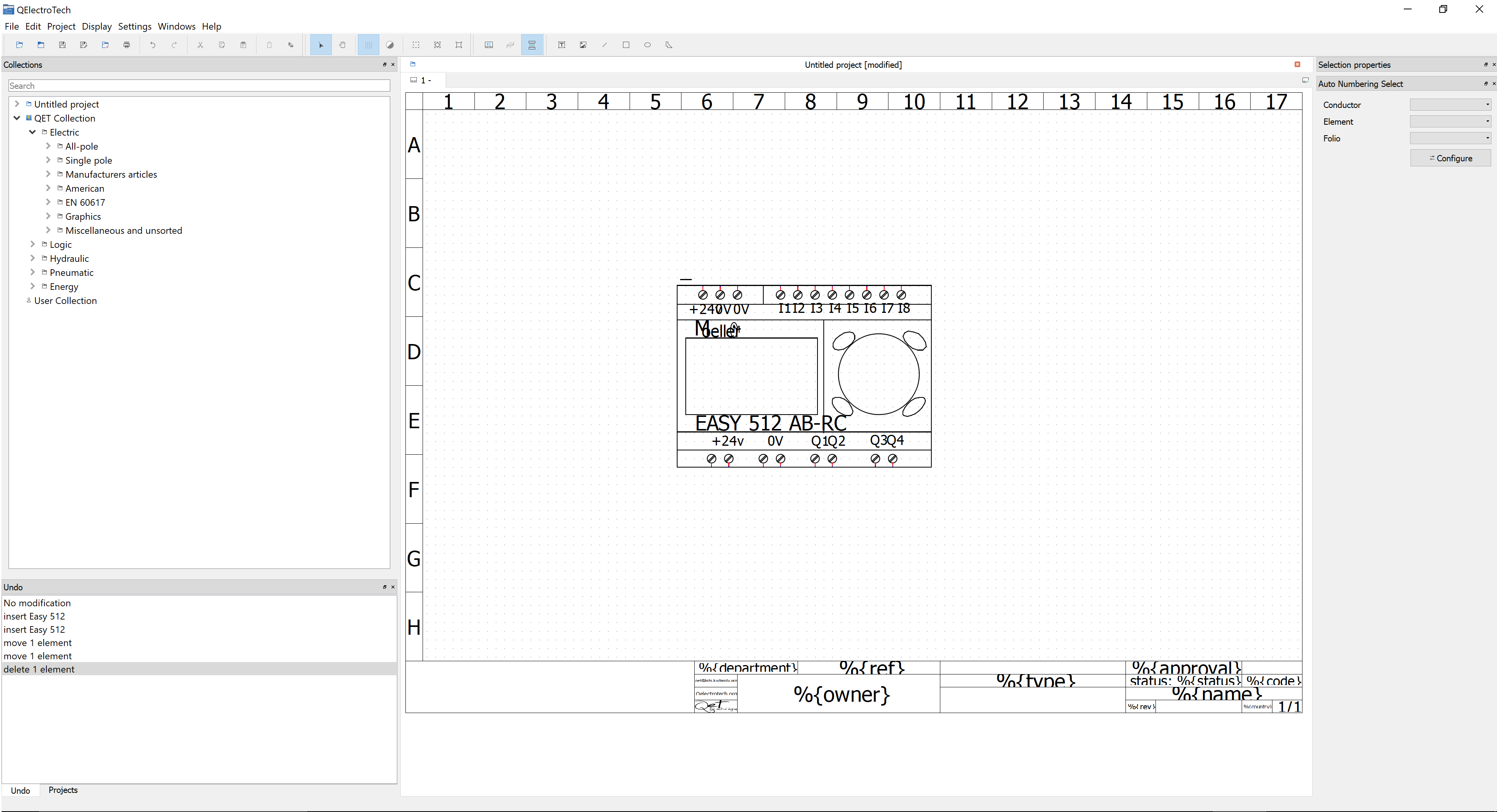

In the past I have enabled Qt::AA_EnableHighDpiScaling only for macOS, a lot of windows users have many rendering problems with Qt::AA_EnableHighDpiScaling, see previous link. #if QT_VERSION >= QT_VERSION_CHECK (5, 6, 0) #if defined Q_OS_MAC QApplication::setAttribute (Qt::AA_EnableHighDpiScaling); #elif !defined(Q_OS_MAC) QApplication::setAttribute (Qt::AA_DisableHighDpiScaling); #else qputenv("QT_DEVICE_PIXEL_RATIO", QByteArray("1")); #endif #endif We don't have 4K screens for check, sorry. |
what problem it caused in windows users?, it seems works just fine in windows 10 at me when i use QApplication::setAttribute (Qt::AA_EnableHighDpiScaling); |
You could see topic here : https://qelectrotech.org/forum/viewtopic.php?pid=4573#p4573 https://qelectrotech.org/forum/viewtopic.php?id=1050 |
Have you see problem like this video when you enable Qt::AA_EnableHighDpiScaling? https://youtu.be/BIBMj2SSBXM |
yes it happens when i select the Print to a physical printer but it not happens when i select the Print to a PDF file |

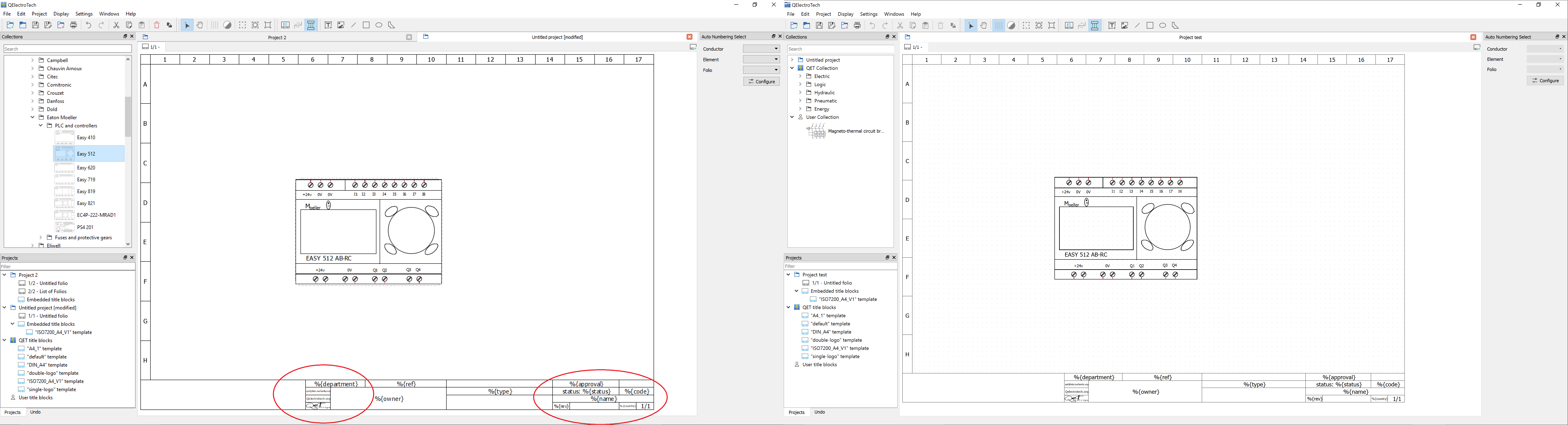

there is one small issue with that code tho, text is no clear |

seems that it works just fine |

by default Qt::AA_EnableHighDpiScaling should work just fine even in windows, but if i understand QElectroTech uses custom made printview and i think it have bug at there somewhere, as it seems it draw lines right way and items wrong way. currently it fix this issue by using rc file, but it seems that it's wrong way todo |
and like i tell before print to pdf don't have this issue, that problem is only with print to physical printer |
if you use that then it make no changes in windows, because in windows mainfest overrides that |
it looks like i found out with 2 day searching that this print bug comes probably at qt QPrint self, i can't confirm that 100%, anyway i started look differences between pdf print and normal pdf print and i ended in printer resolution() in this HighDpi.patch i disabled the manifest as it seems we not need use that for now. HighDpi.patch (2,568 bytes)
