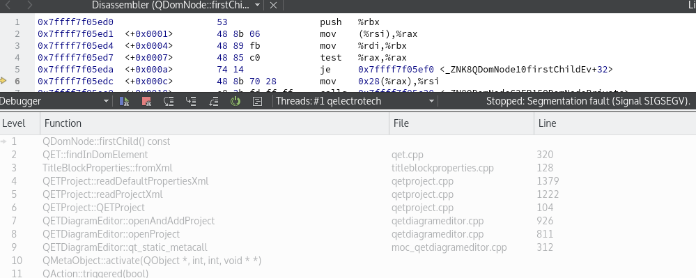

@ 4901, Quick check: It crashes immediately on opening a drawing
- even a brand new drawing now created with it, place one element, save, close, open -> crash nomicons/sad
OS: Mageia 6, 64bit, Plasma
Do you want me to check something specific?
Screenshot_20170205_164316.png, 93.82 kb, 999 x 399

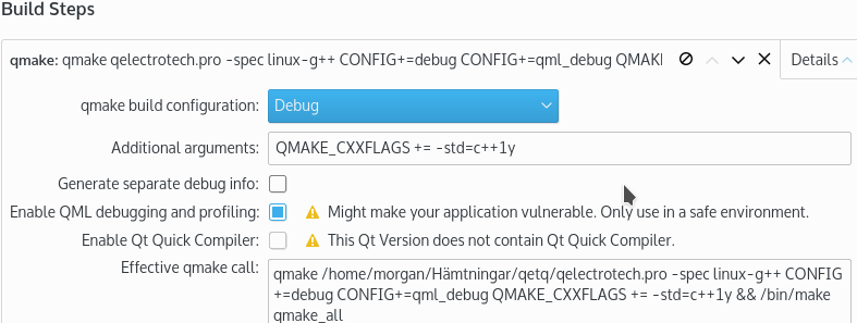

Never been in this land before... I just read your note above and added option like in image below, but i get result:
***Unknown option -std=c++1y
16:57:50: The process "/bin/qmake" exited with code 1.
[color=#333333]
What can i try?
[/color]
Screenshot_20170205_165934.png, 55.7 kb, 787 x 297

No, I saw with Joshua and we think is more prudent to report this big change after the release, I prefer revert it.
Re: Suggestion: Have automatic conductor creation disabled by default.
OK, i go back to 4899 for now.
No, I just push r4902.
r4900 run very well here, I think only distribs with old Qt have crashes.
I upload new builds.
