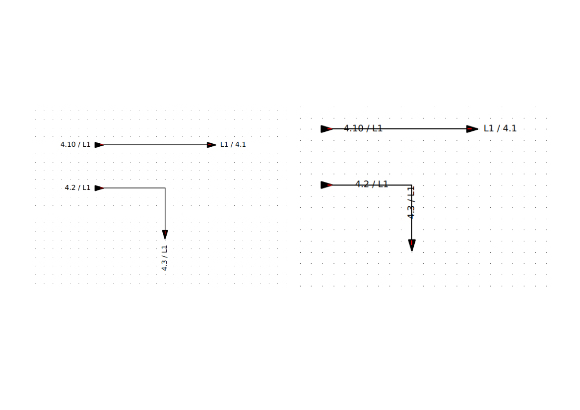

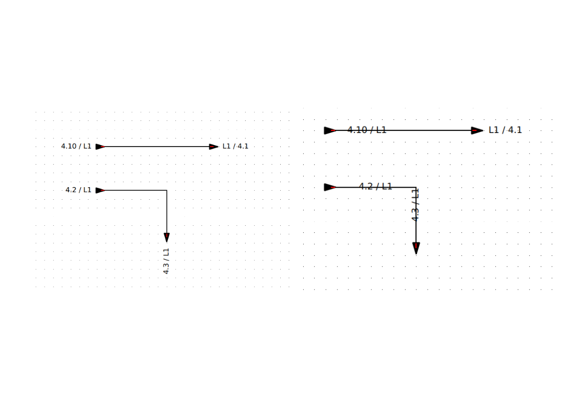

But i had a problem with the composite text with alignment right, every close and reopen from project, moves text, see in attached pic's.
It does not matter if the alignment top, center or bottom.

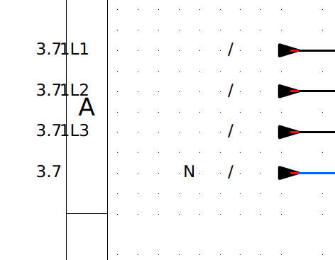

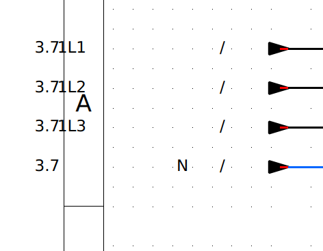

I don't think so.
I changed back to my old with three text items, but with alignment right on %{lable} and %{function} and they move now to the other side.
Only / stand still (alignment left).
See pic.
[s]This Problem comes only on folio referencing, all other work great.[/s]
This Problem have all Slaves like coming arrows and contacts.
Unfortunately i forgot my version, sorry.
QElectroTech V 0.70-dev+svn5396
Bildschirmfoto von »2018-06-19 16-45-25«.png, 12.41 kb, 472 x 367
