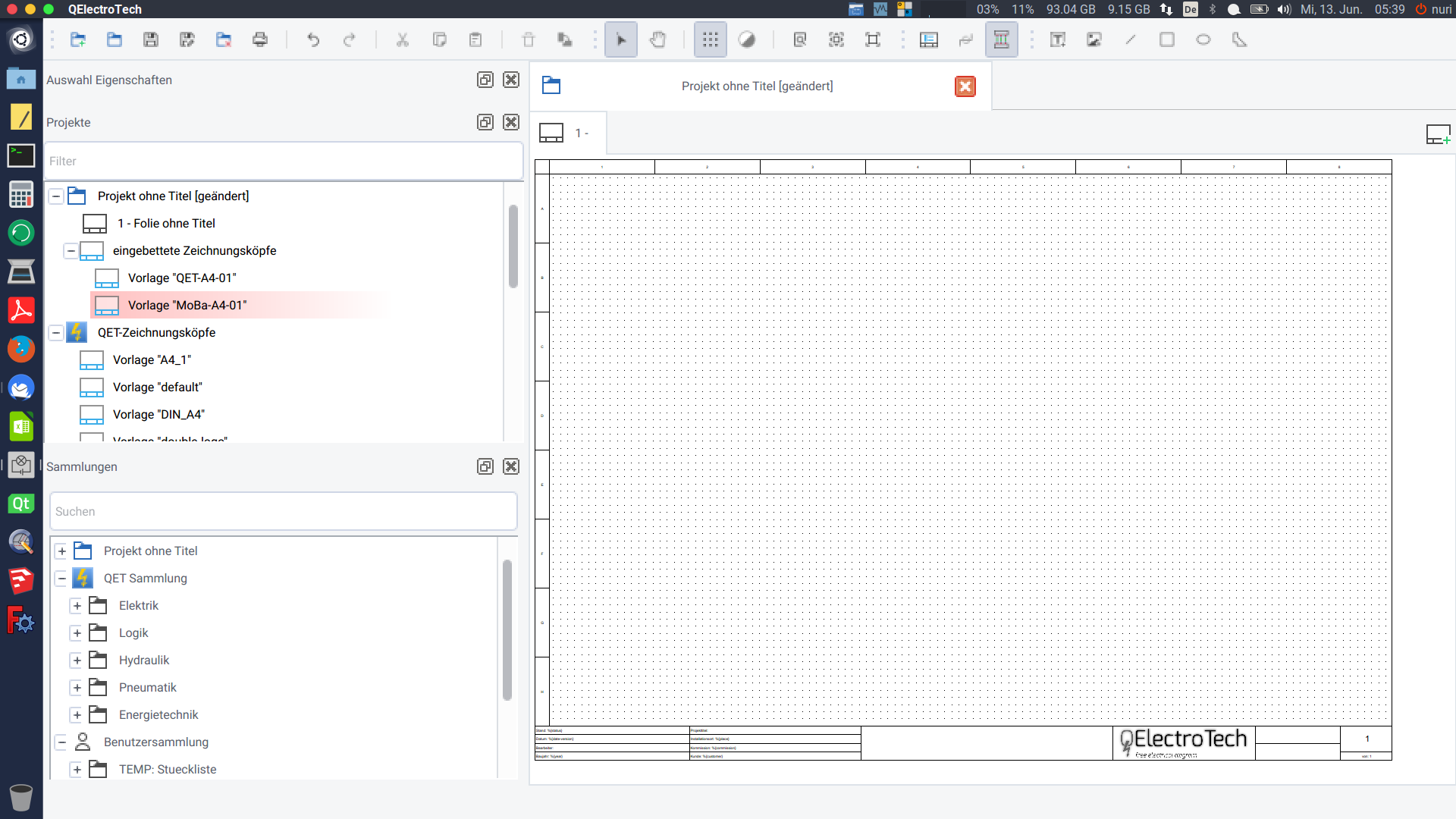

Yesterday I wanted to make some small changes in a schematics and QET v0.6 opened with a 2x bigger dpi scaling as usual.
At the moment, my productive system is still Ubuntu 16.04 with Unity, FullHD screen (1980x1080px) and QET v0.6.
I've have not used QET since a few weeks so I don't really know when the problem appears.
I have made a system update for a few days and maybe the Qt librairies have been updated, with some bugs?
I have tried to reinstall QET but that brought no solution.
I have installed QET v0.5 from the official Ubuntu repositories and the scaling of the GUI was normal, not 2x bigger as with v0.6.
It's very hard to understand where the problem is. I'm using my PC very rarely at this time, I have not "tuned" any system configuration.
QET v0.6 behaves as it was displayed on a 4K screen, but I only use a fullHD screen.
QET v0.6 behaves normal, with the right DPI scaling on Debian sid with Gnome Shell (same PC, same screen).
Here how it looks on my productive system:
hidpi_on_fullscreen.png, 138.94 kb, 1920 x 1080

Re: Wrong GUI scaling on fullHD screen
@Re-searcher:
only QElectroTech starts with a wrong dpi scaling. Unity and all other apps are not concerned by the problem.
@Scorpio819:
launching QET with:
QT_AUTO_SCREEN_SCALE_FACTOR=0 qelectrotech
does not help. It makes no changes.
The problem does not occur with QET v0.5
It's very strange, I don't understand.
