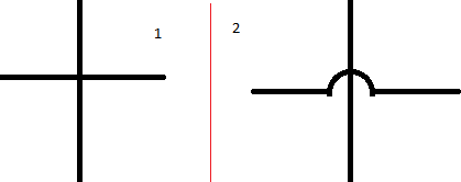

Right now 2 cable cross they form an intersection like figure 1(img attached). I would like to ask if there is an option to make it like figure 2.

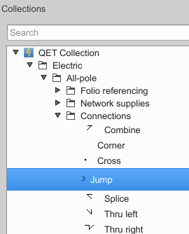

Hello,
In the QET Collection you will find elements that you could use. (Only from the newest version 0.6 I mean).
Best regards
Stebo
