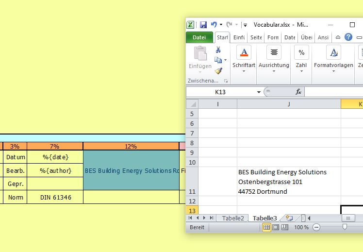

Is it possible to write in the same cell of Qelectrotech template 2 or 3 different lines like in Excel? (take a look in the attached screetshoot)
Thanks in advance!

Yes is possible :
https://qelectrotech.org/forum/viewtopi … 1562#p1562
But not perfect :
<logo rowspan="2" resource="No logo" row="0" name="" col="8"/>
<field rowspan="3" valign="center" hadjust="true" row="0" align="center" fontsize="3" name="title" col="9" displaylabel="false">
<value>
<translation lang="fr">BES Building Energy Solutions
OStenbergstrasse 101
44752 Dortmund</translation>
</value>
<label/>
</field>
You could use return code carriage
<value>
<translation lang="fr">BES Building Energy Solutions OStenbergstrasse 101 44752 Dortmund</translation>
</value>
