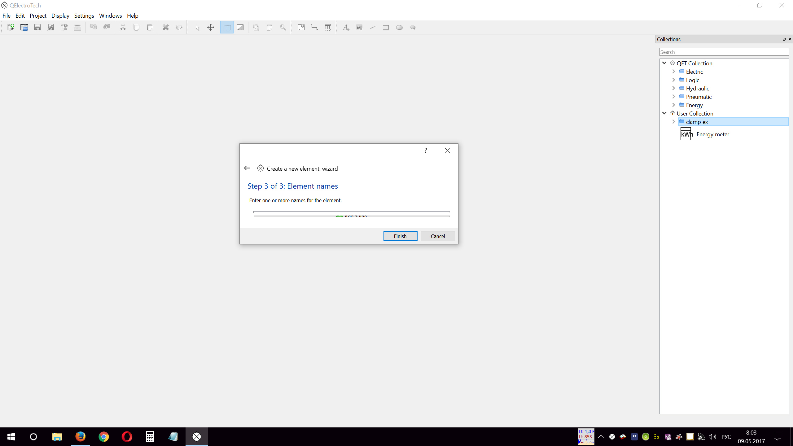

I can not write a elements name field. I use PC with Windows 10 Pro (x64) Version 1703  and qelectrotech-0.6-RC1+svn4955-WinXP-WinVISTA-win32-readytouse. Display Size: 27 inches. Display Resolution: 2560x1440 pixels.

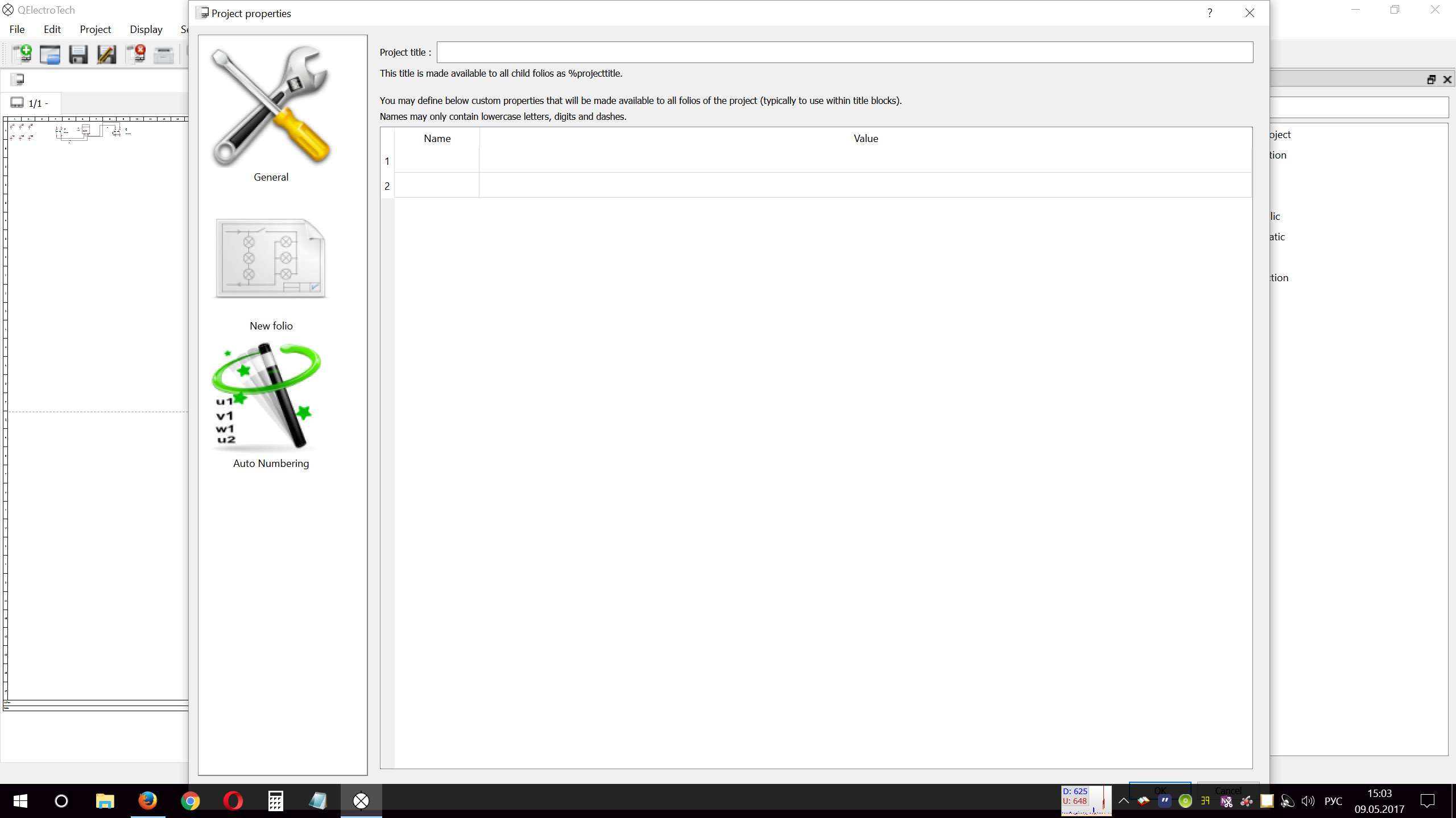

I can't enlarge this windows.
I see a normal field, but too large icons and blurred interface in version: Installer_QElectroTech-0.60-RC1_x86_64-win64+svn4955-1.exe and qelectrotech-0.60-RC1+svn4955-x86-win32-readytouse.7z. Their large interface does not fit into the window.
So I use version: Installer_QElectroTech-0.5_x86_64-win64-1.exe and qelectrotech-0.6-RC1+svn4955-WinXP-WinVISTA-win32-readytouse.zip.
I haven't decided which version to prefer.

What your machine, you use a laptop with QHD or 4k screen?
Qt > 5.6 add support for these screens.
If QET detect the Qt version embedded >= Qt 5.6 then add HDPI OS support.
QET 0.5 version and 0.6-RC1-Win XP-Vista use Qt 5.1 framework.
http://blog.qt.io/blog/2016/01/26/high- … in-qt-5-6/
http://windowsreport.com/fix-hidpi-issues-windows-10/

Re: Why do I have narrow fields in the "Create a new element: wizard"?
Your screen has a WQHD definition, I think is better with Qt HDPi enabled in QET (automatic if  >= Qt 5.6), otherwise just config your Win 10.
