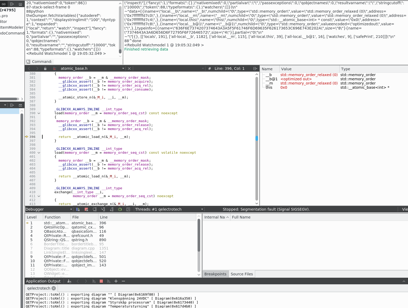

I caught a crash.  Unfortunately i do not remember what i did before; i fooled around with it this morning, and then i have been in workshop, now i just closed it saving, and it crashed.  As always, i run it in debug mode.
SsegfaultClosing.png, 337.05 kb, 1551 x 1170
