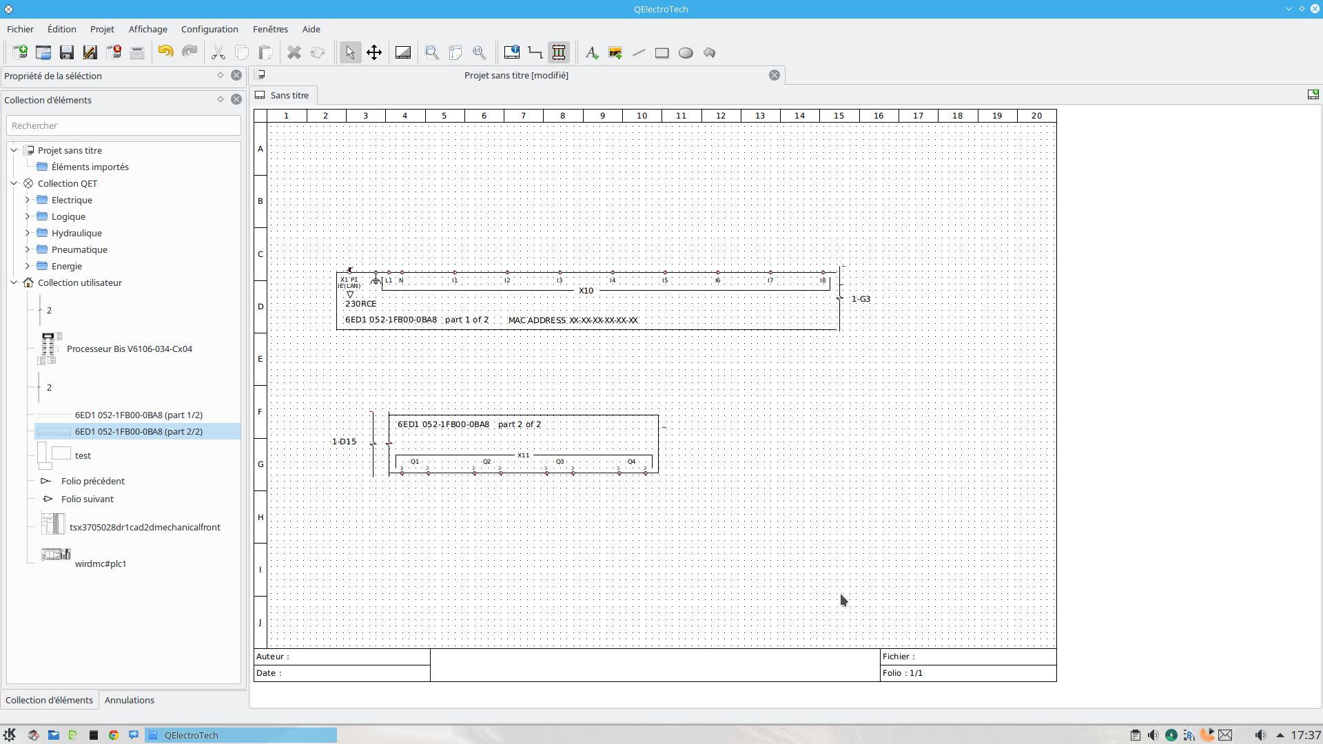

how can i get the attributes of a conductor be visible in the drawing
function and net

you need to add these attributs in new reports elements.

No, i think is easy to users to draw and configure these elements.
And btw is easy to adapt for your speciality you want.
