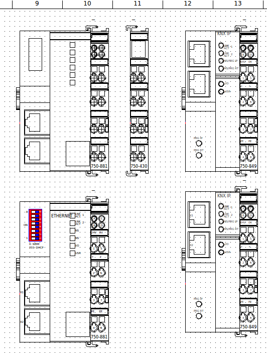

I first inserted a element from the user panel into the drawing
then i open the element in the panel and make changes on it, save it and then reinserted that element again into the drawing, selecting the option on replease the existing one with the new one
Theni get 2 elements with a different layout, after save, close and reopening the drawing, the 2 element have the same look.
I think you need a reload page after a save command to have the correct view

About THE reload, it is not THE collection that Needs a reload, but THE page it self, when i close THE drawing and reopen it then THE drawing is ok,
 you need a page reload after inserting a modifyed symbool in THE existing page
