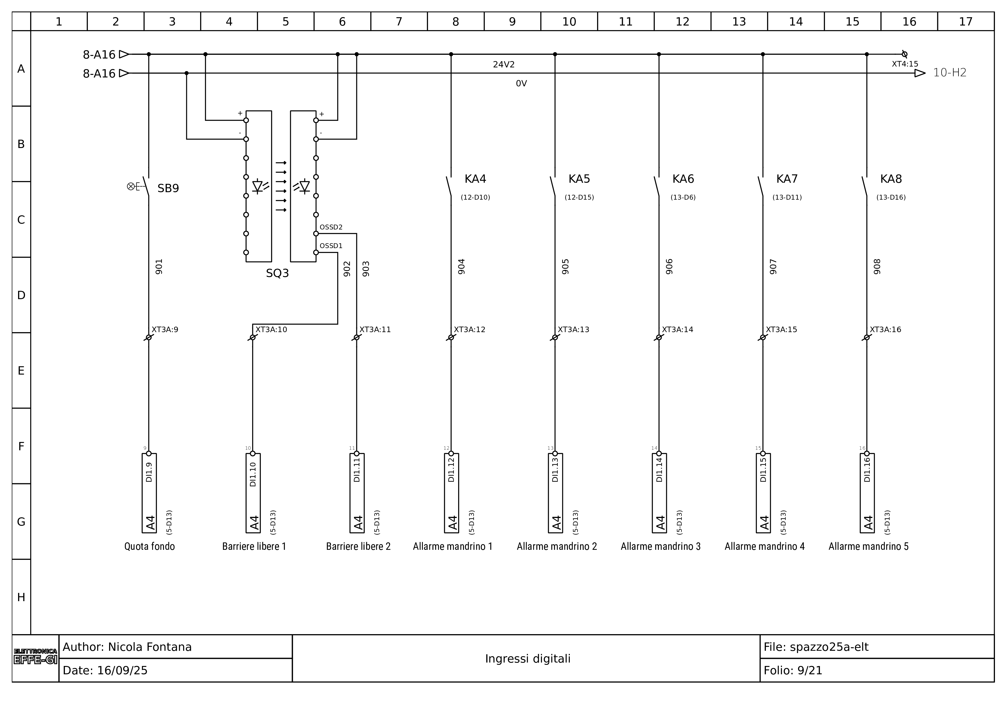

can we get also the I/O elements you designed for this?
also I see the I/O modules have no terminals
how do you plan to make your shematic?
As stated above, I/O are expected to be used via cross-references. This is the way I'm used to do I/O too dense to be used with explicit terminals. Here for example is how I define the last 8 digital inputs of A4 in the above schematic:
https://nicola.entidi.com/assets/qet-di.png
Unfortunately I had to misuse QElectrotech a bit to achieve my goal: I'm using NO contacts for inputs and NC contacts for outputs.
4 (edited by LievenC 2025-09-29 08:17:32)
Re: Some Beckhoff elements
I cleaned the elements, put all connections to grid.
where are the 2 slave elements you use as NO or NC ?
Thank you! I'll check them whenever I need to write my next schematic.
Any valid slave element should work. I did not share them because that folder is a bit of a mess.
Anyway, in the attached archive you'll find the ones that I normally use.
