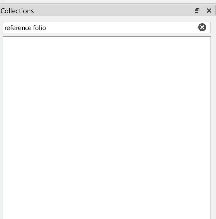

It appears that I'm missing elements described here:
https://download.qelectrotech.org/qet/m … owing.html
and I'm missing the reference folio element.
Please see attached pictures.

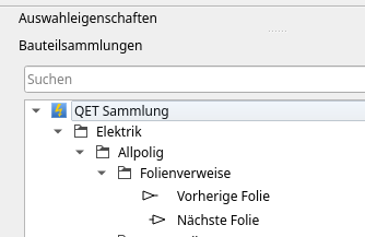

did you go through the element-tree a bit?
see attachment
Found it, thank you. I didn't realize it was called "coming" and "going". I thought it would be named "Reference Folio" like the manual states.

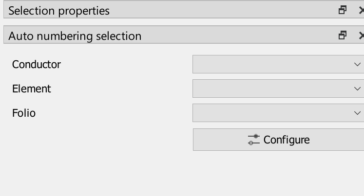

I am still missing the auto numbering formats described here. Please assist. I have to manually apply numbering.

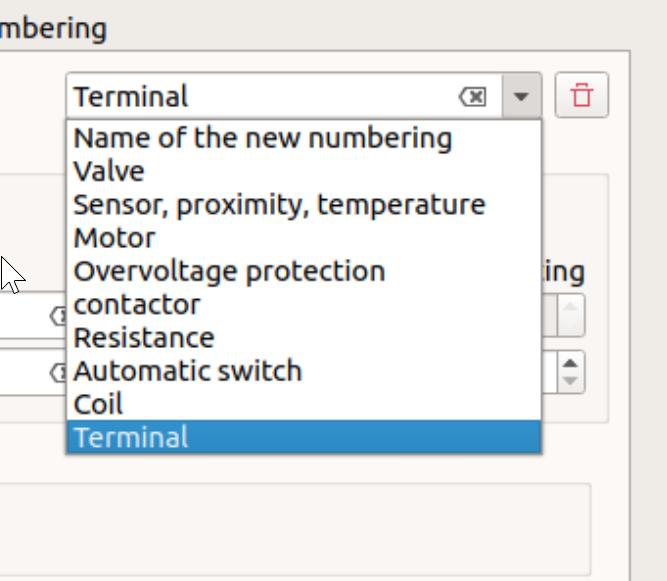

Bump on this issue.
Did you read, what's written on the linked page?
QElectroTech allows defining multiples auto numbering patterns. It also provides many flexibility on the creation of auto numbering pattern using text, variables and sequential numbers.
YOU define the rules for your project!
So these definitions are not defaulted in the program?
No, you need to create yours rules and name it them like you want!
