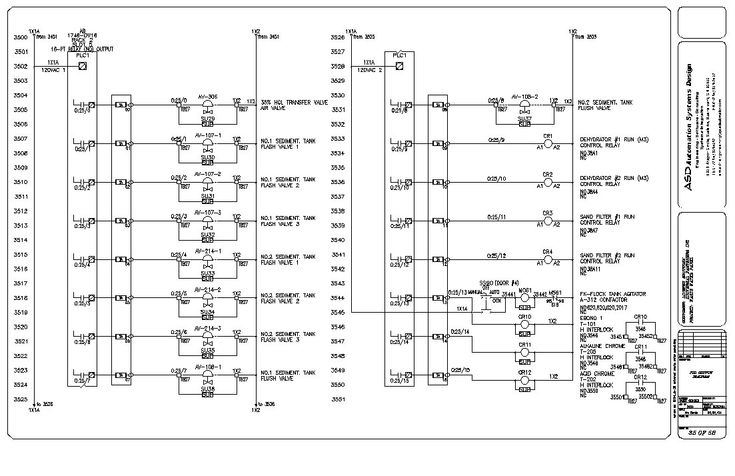

achim wrote:
There's no way to do that because it doesn't make sense.
example.jpg, 60.53 kb, 735 x 476
Re: Row numbering
I don't see any particular reason to draw your diagram exactly like that in this example: Is there one?
The attached drawing could just as well be drawn on two folios in horizontal orientation.
However, in QET there is no way to continue the row or column numbering over several folios across the entire circuit diagram.
Re: Row numbering
I need to make a diagram for new connections and modifications to an electrical panel that already has that type of row numbering, so I must adapt it to be as more identical as possible.
I also thought that selecting all the diagram and rotating it would be enough to use the columns but no, it just rotates the symbols each one individually.
