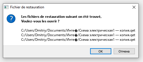

At startup, the program constantly tries to restore the file, this file is not needed and is deleted.
How to solve this?

you can delete it yourself by Windows explorer, see PATH in the dialog box.
The file has already been deleted. The dialog box appears constantly. Is it possible that Qelectrotech is storing crash information?
Sorry, is stalesfile file to delete,
manual delete files on C:\Users\Dmitriy\AppData\Local\stalefiles\QElectroTech\
Super, everything worked out.
Thanks.
