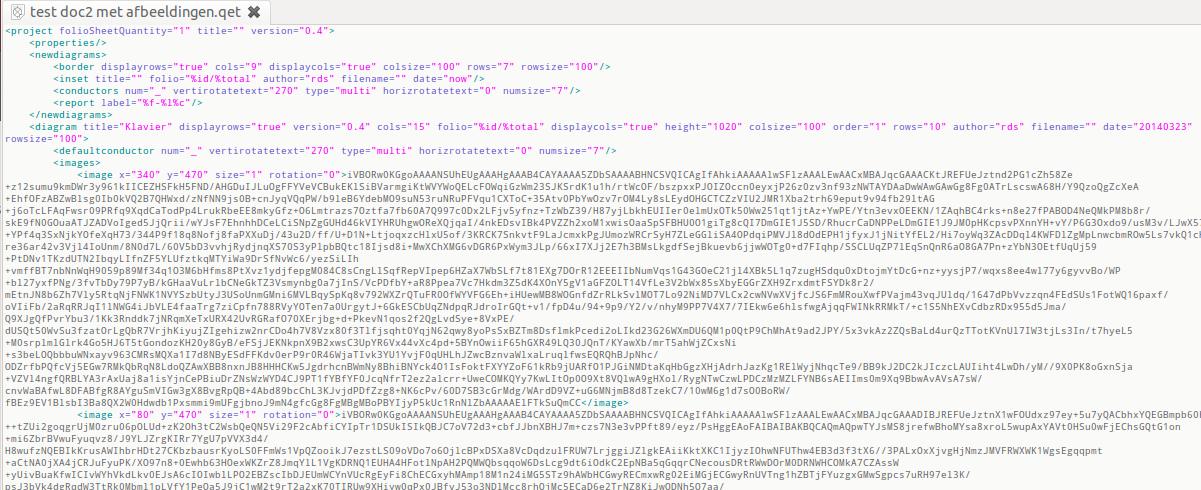

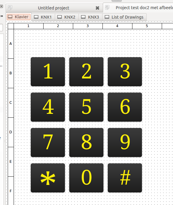

4 (edited by rdsivd 2014-03-29 11:12:48)
Re: XML coding in elements
Very strange i first inserted the png into a drawing of a project (see "schermafdruk1.png")
and is embed into the project file
and then copy the xml code into a elmt file
i have make the png with gimp
i also see that when i use a titelblock with logo the png is not embed but linked
the cymbo itself is maked with the element editor
schermafdruk1.png, 43.5 kb, 584 x 695

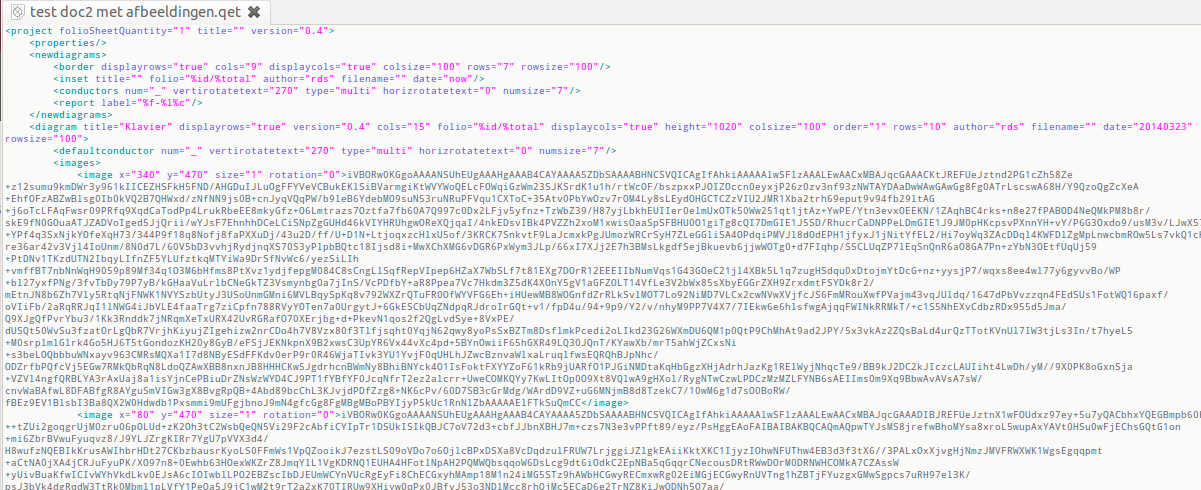

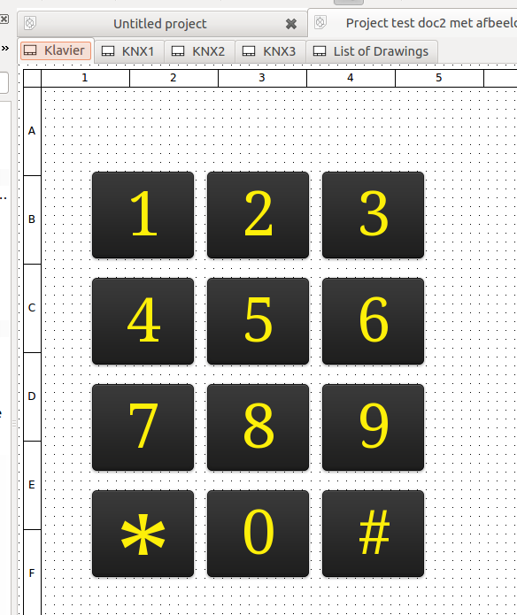

5 (edited by rdsivd 2014-03-29 11:18:46)
and the code of "schermafdruk1.png"
schermafdruk2.png, 213.85 kb, 1201 x 490
