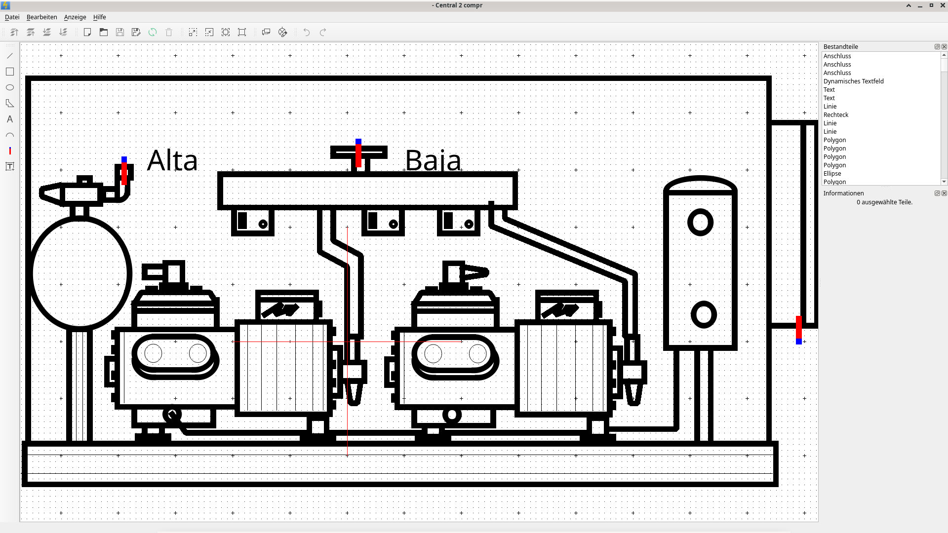

I have included two screenshots in the appendix to show that the differences are hardly noticeable in most cases - not even with the selected (rather small) example element.
