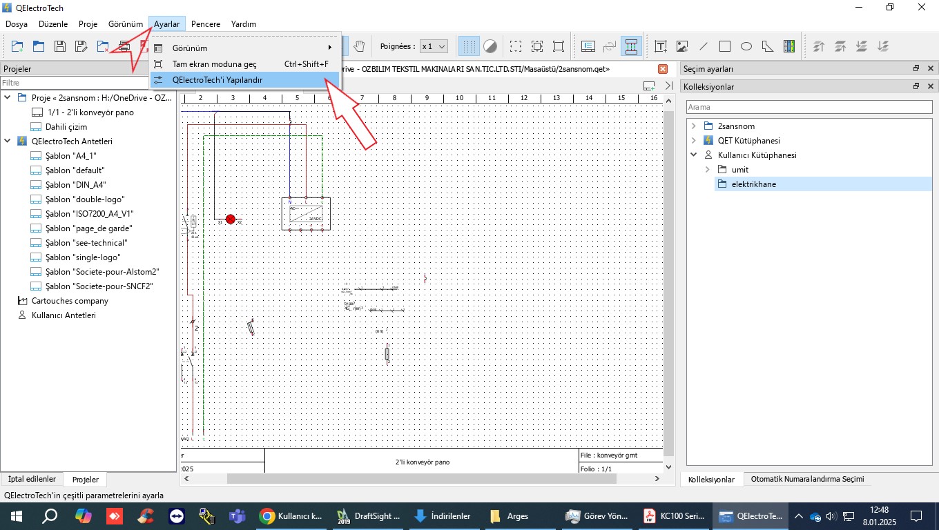

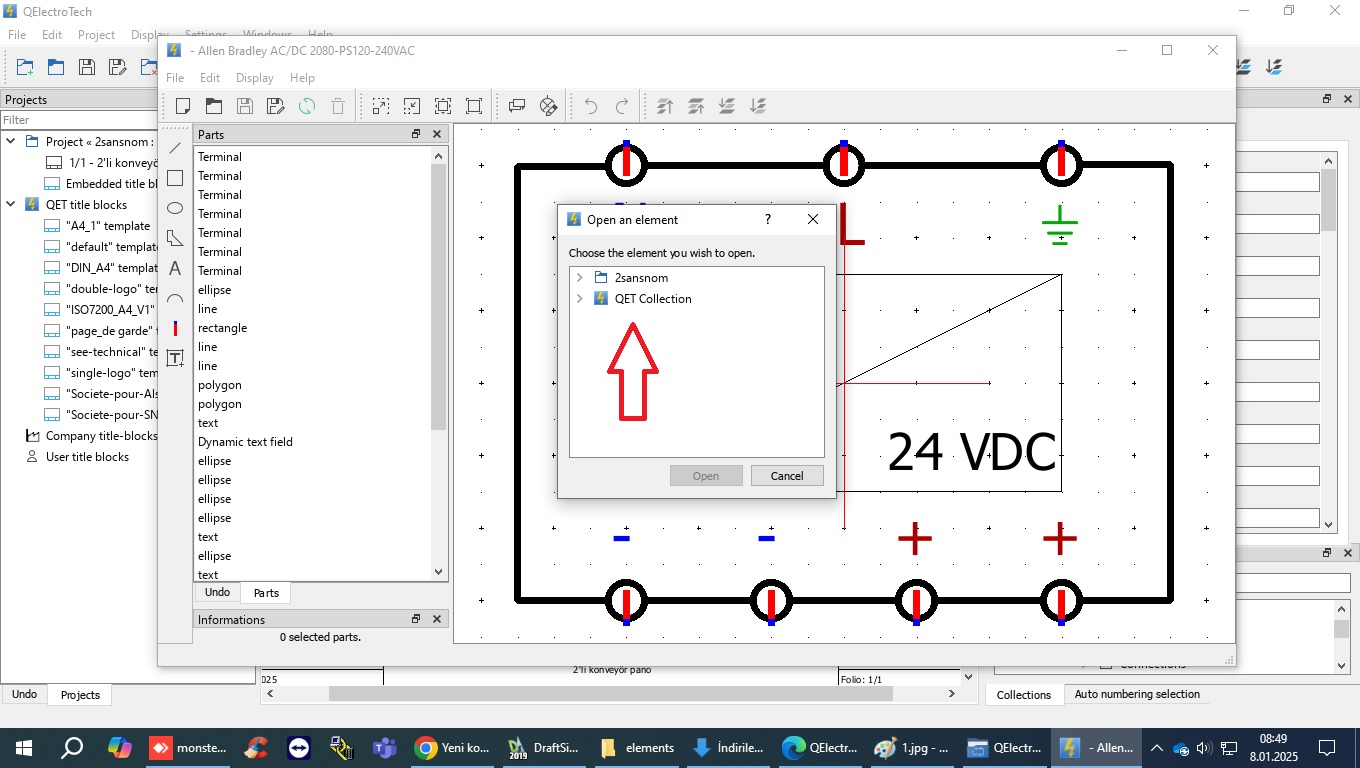

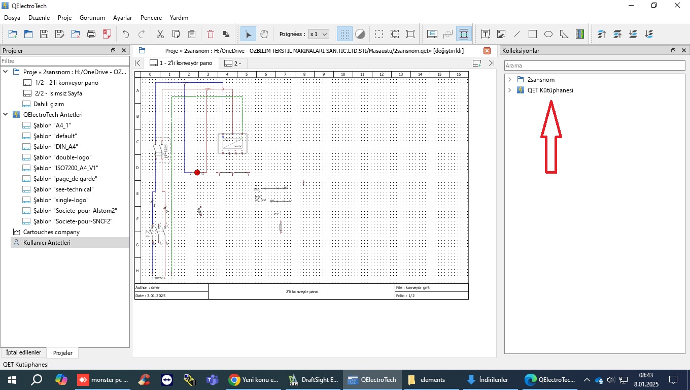

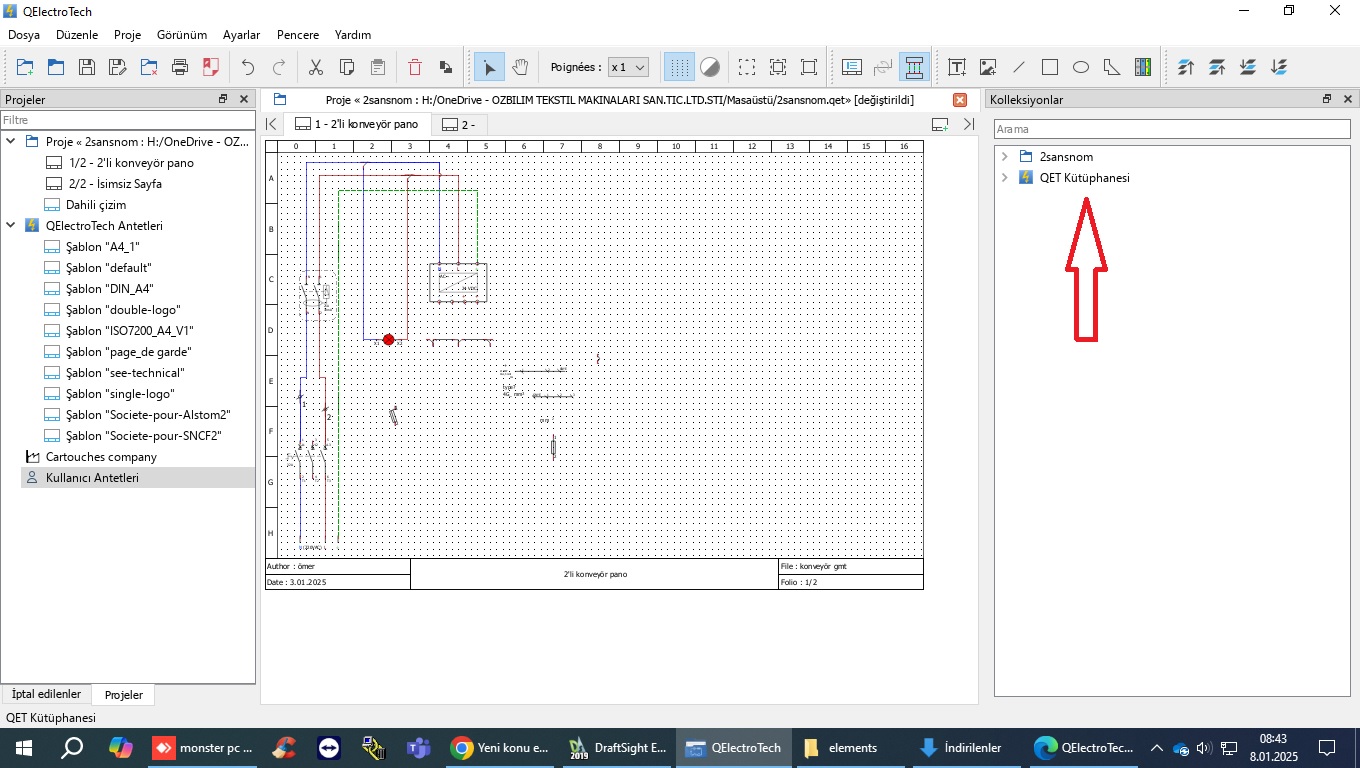

Hello, the "User collection" folder does not appear on my desktop computer. How can I solve this problem?

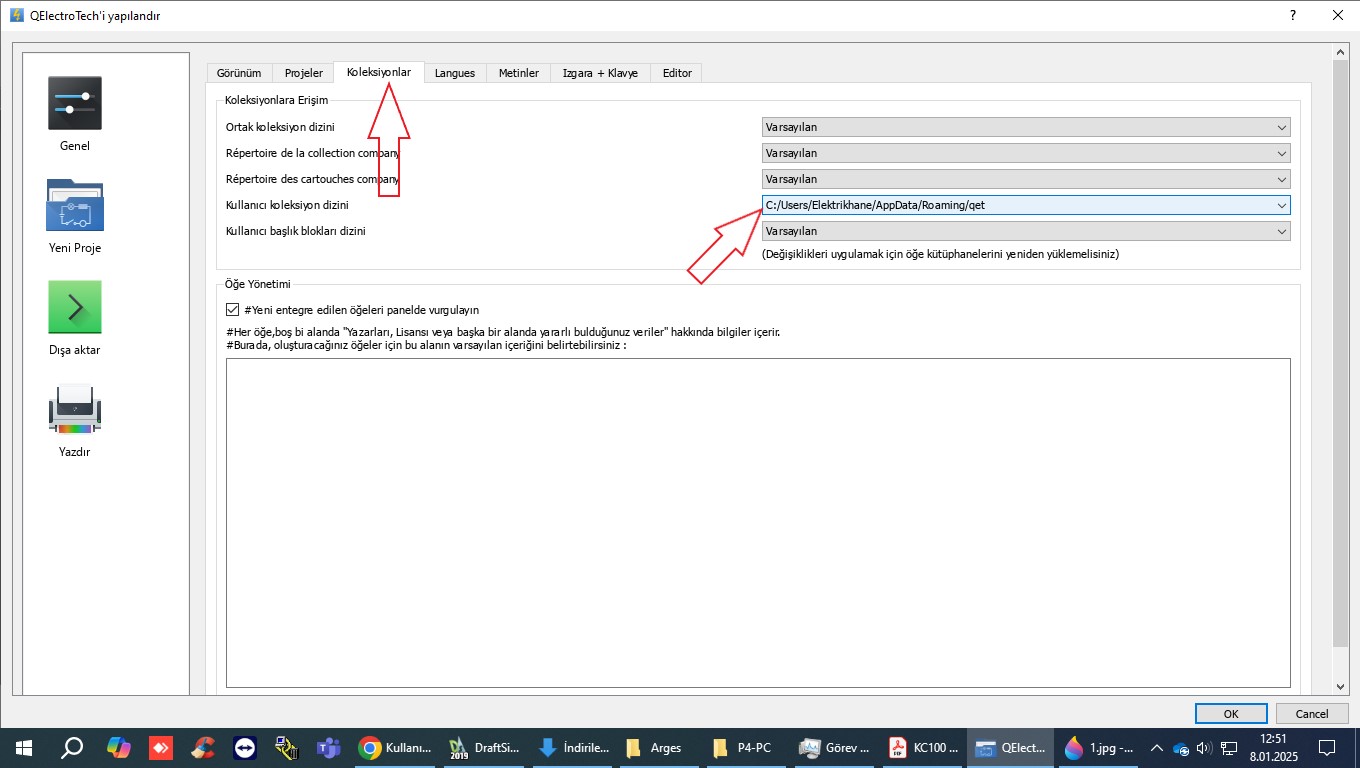

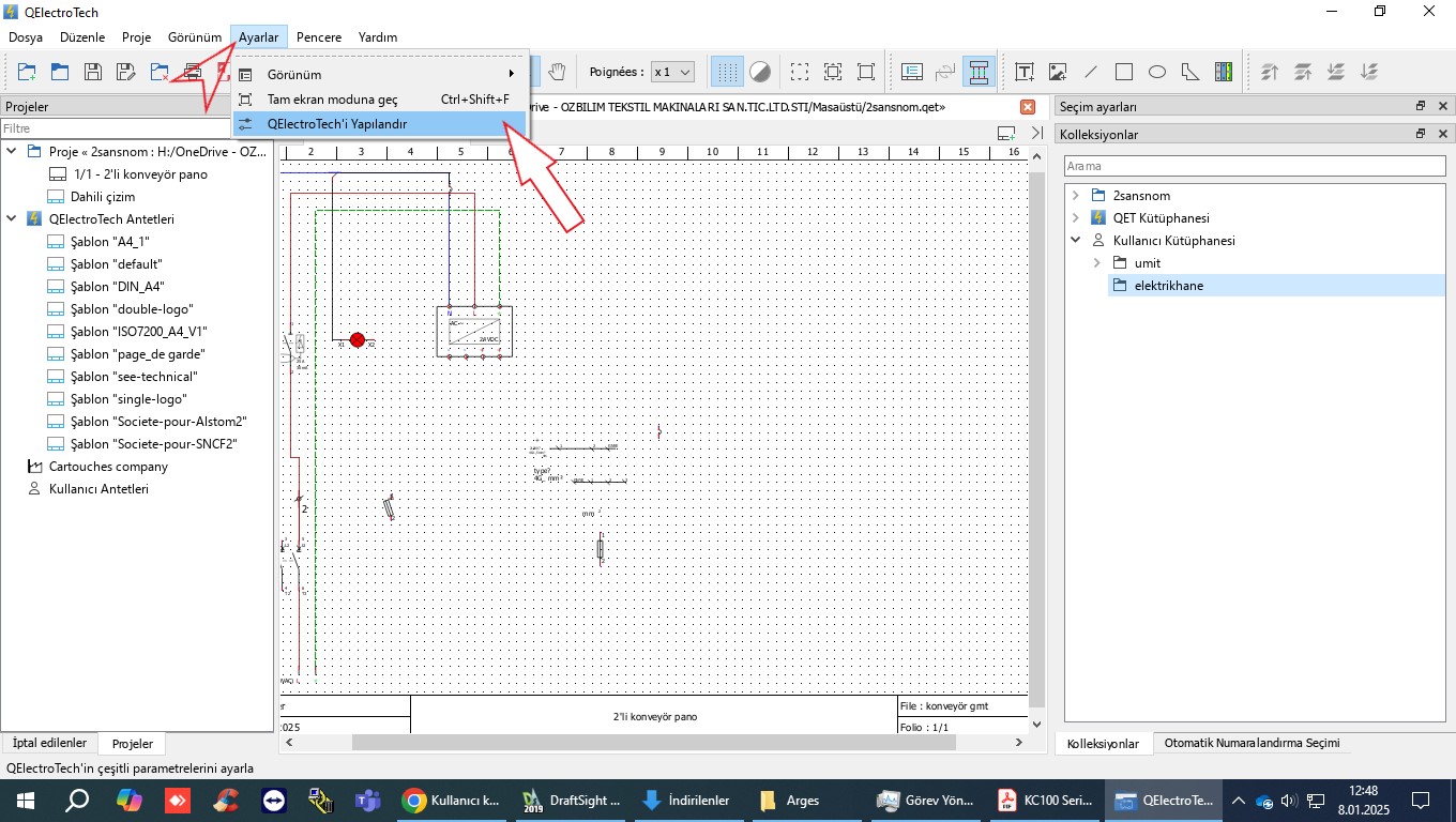

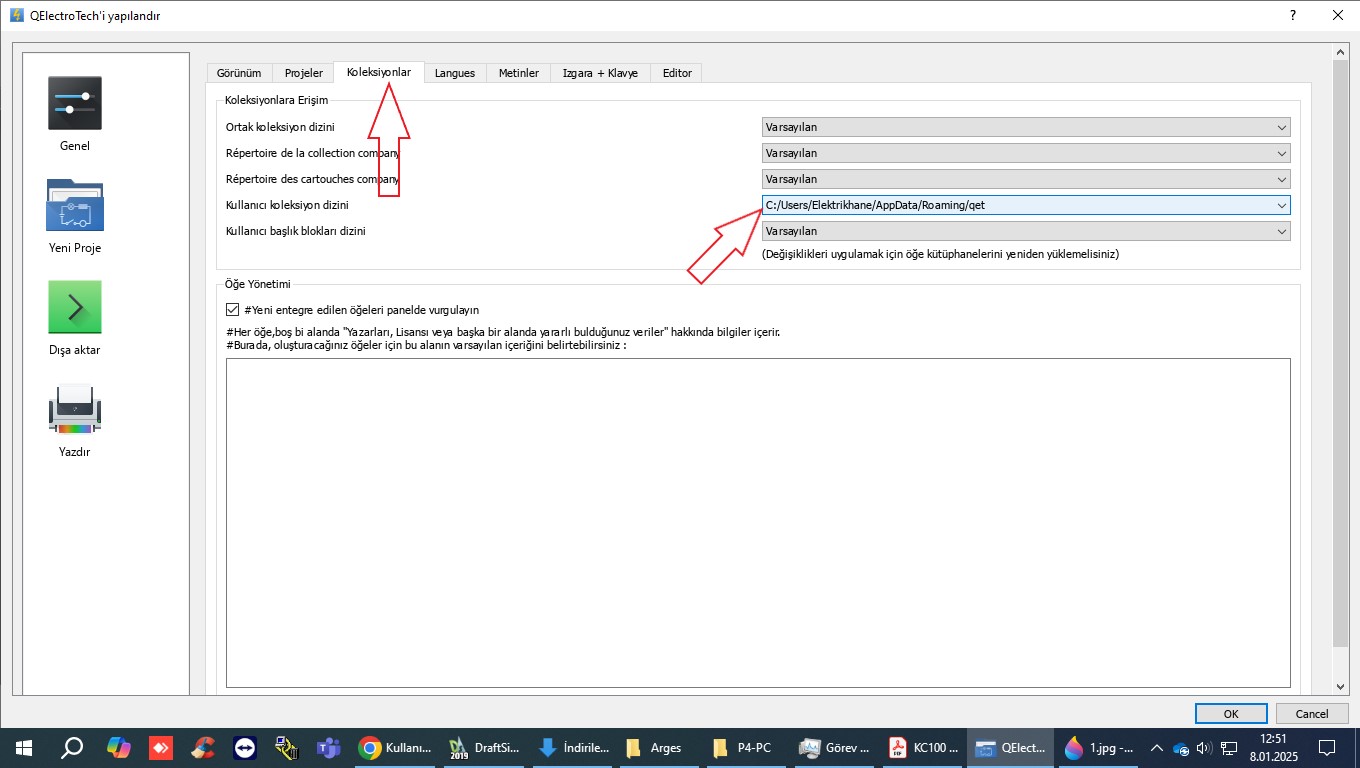

I found a solution to the problem myself, I'm leaving an example in case it helps someone else.

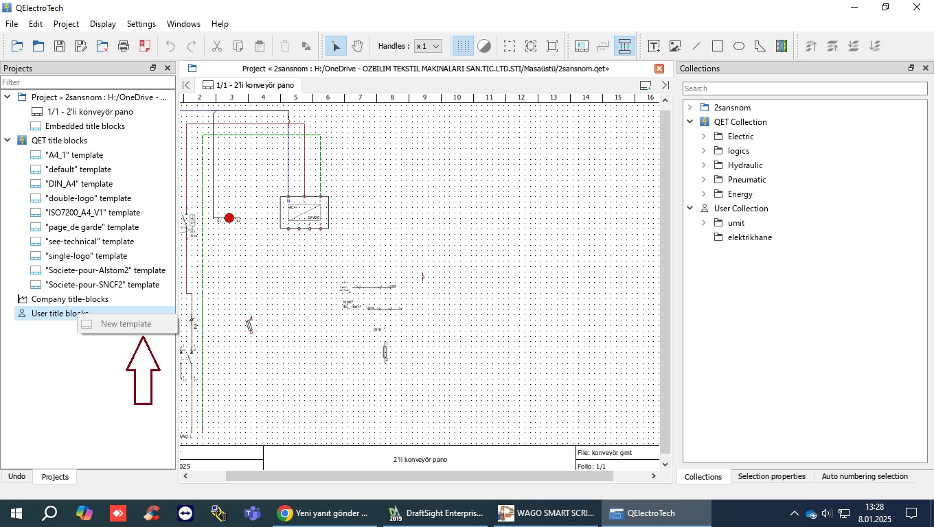

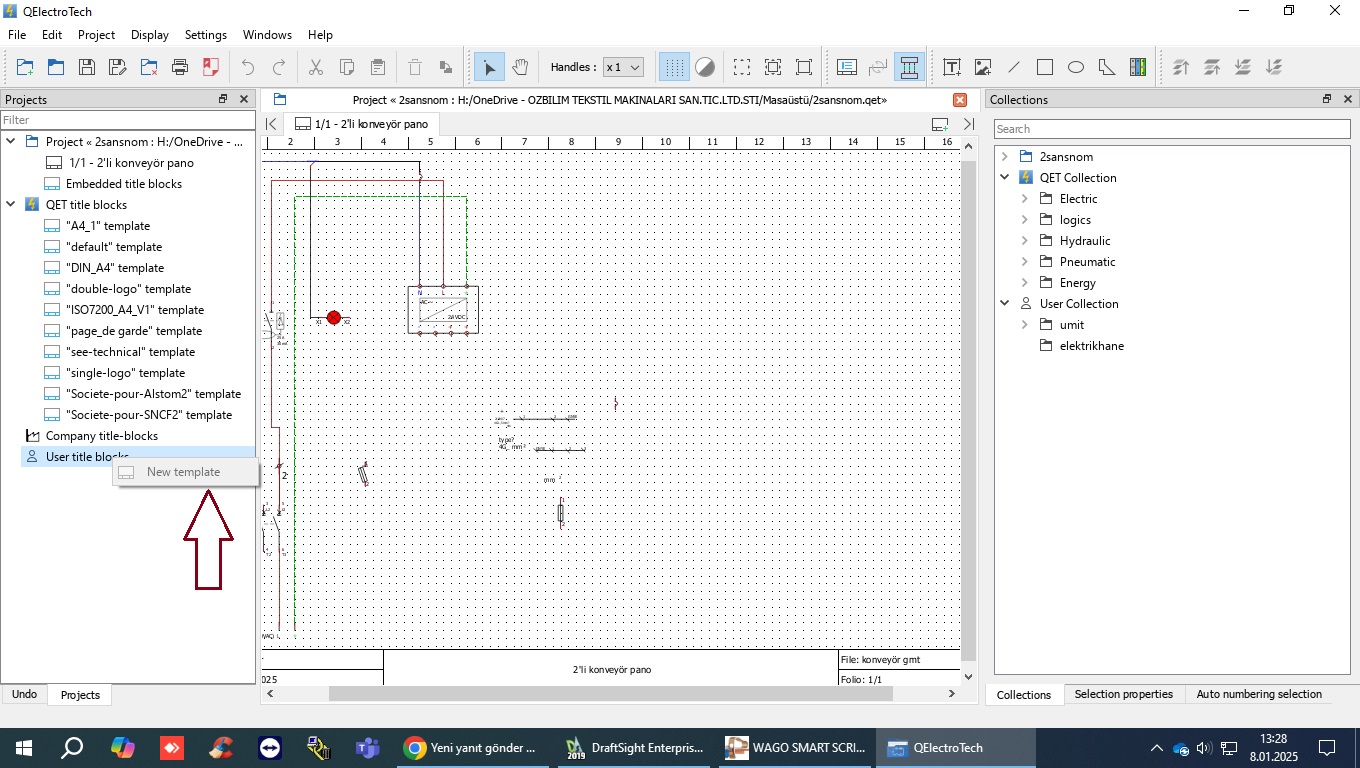

There is another problem, I haven't solved it yet, I need help. I cannot create user title blocks.

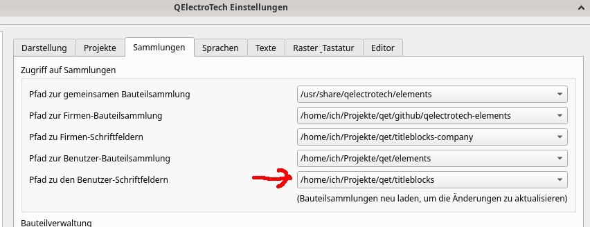

Maybe the path to user-titleblocks is not writable?
Did you try to set another path to user-titleblocks?
can you show with an example

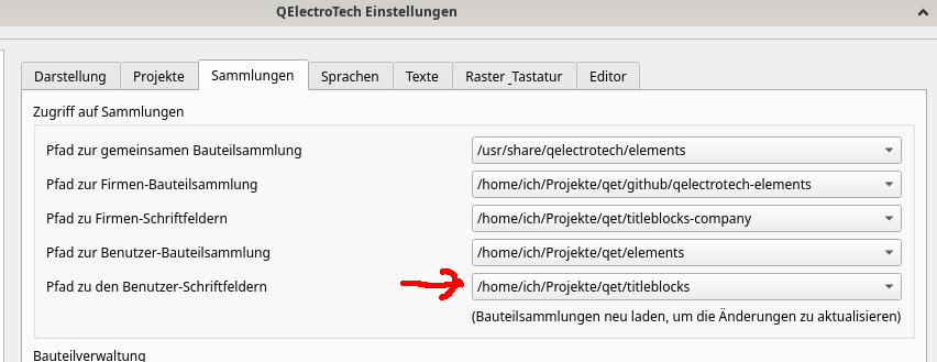

It's the combobox under the one for user-collection in QET-Settings.
I use Debian GNU/Linux and most recent dev-version, so the paths look different from those, you use!
Thank you for your help, it seems active now.
