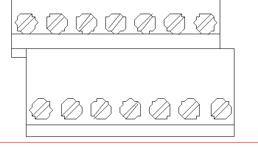

Hello Vadoola!
Salut Laurent !
Some questions about default settings in dxf2elmt:
In all dxf drawings I had to convert so far, the individual splines were not really long or complex. That's why I'm wondering whether we really need 100 segments in the corresponding polygon for each spline as a default setting for the conversion to QET elements?
I have tried a few files with different numbers of polygon segments and I think that 10 or 12 points should be enough for good results.
Do we really need the full precision of up to 14 decimal places from dxf for use in QET elements?
For all graphical elements in the element editor, a maximum of two decimal places can be entered or edited and the graphical editor only allows changes in the tenths range. Therefore, in my opinion, it is completely sufficient to use a maximum of two decimal places in conversion programs for QET elements.
Both default settings lead to the element files being unnecessarily bloated, which can only be corrected very poorly or not at all with the element editor's on-board tools.
An example is attached:
One of the two elements "weighs" only 292.9 kB, the other "weighs" 3.4 MB! A factor of almost 12 – in this case I would say: Size does matter!  nomicons/wink
(Remark: In the elements used in the appendix, I have inserted a meaningful definition line by hand so that QET displays the elements correctly.)
I can correct the number of decimal places with QET_ElementScaler, but I can't reduce the number of polygon points of converted splines with it...
In this context:
I also noticed that the converted element file contains polygons with a only one point! QET_ElementScaler filters them out, but should they not be eliminated from the element file in the first place?
Best regards
  plc-user
I agree that 100 does seem like a lot and could make the resulting element unnecessarily large. This should be an easy change, I'll do some testing to see how 10-12 points do, and make sure it still works well.
Completely agree, I can change the default behavior to round to 2 decimals of precision.
While doing some testing this past week on QET element files I found on github, there were a few I found converted with (I believe) the old C++ dxftoelemt that had polygon's with only 2 points. I created an issue (https://github.com/Vadoola/dxf2elmt/issues/120) to try and filter those out and convert them to lines. I could also easily filter out polygons with only 1 point and just not write them out, but I'll take a closer look at the file you attached and try to find out WHY there are single point polygons in the first place. Perhaps removing them isn't the proper way forward and they have a purpose and need to be handled differently (like a point that needs a thickness or something, that is converted to a circle element?)
Antonioaja has also responded to my pull request (https://github.com/antonioaja/dxf2elmt/pull/3). I asked for clarification if he is fine with my fork being the QElectrotech recommended fork, but it sounds like he said the project did what he needed and had no real plans to continue development.

plc-user could you share the original dxf file that created these single point polygons?

Hello Vadoola!
Salut Laurent !
With such conversion tools, we should always consider what the end result should be used for!
As we say in German: "The worm must taste good to the fish, not to the fisherman!"
I have already said this in other forum posts:
QET is primarily a program for electrical (pneumatic, hydraulic, etc.) circuit diagrams with the additional function of also sketching assembly plans.
QET is not a tool for drawing exact scales on a specific paper format. Therefore, in my opinion, we do not need the full precision with 14 decimal places and the 100% precise approximation of polygons to splines from the dxf file.
This is also the reason why I try to reduce the size of polygons in the QET_ElementScaler if, for example, two successive points lie on top of each other, but that's another topic...
My knowledge of DXF is poor, but as I see it, many commercial programs, for example, export single circles as multiple splines, which can never become a space-saving circle or ellipse again when converting. Unless you rework the element in the element editor by hand, which in the end often leads to the realization that you could have drawn the element yourself more easily and, above all, more quickly...
So here, too, we have to find a good compromise between "I recognize the essential features of the element" and the absolute precision of the original drawing. This also includes the polygons with only one point each: The original dxf program must have "thought" of representing some parts as 1-point polygons, but do we need that in the QET element? I didn't find anything missing from the example!
On the contrary:
In the dxf and therefore also in the resulting QET element, there are very often polygons that lie directly on top of each other, but which are not recognizable as individual graphic elements.
Nowadays, this is often due to the fact that devices are no longer made from several 2D drawings, but are created directly as 3D models. A 2D dxf drawing is then made from this, which accordingly also contains many hidden lines that inflate the resulting QET element, but do not provide any additional information.
This is in no way intended to criticize antonioaja's and Vadoola's work: On the contrary!
I really appreciate the work, but we should also think about the purpose of the result.
With this discussion I would like to make the program even better!
Attachment icon dxf-testfile_for_1-point-polygons.dxf 235.18 kb, 225 downloads since 2024-09-09
Re: New .dxf to .elmt Conversion Program
This is part of why I wanted to see the original dxf that created these single point polygons (thank you for attaching it). I agree that a single point polygon makes no sense, and these could possible be lines that extend out in the direction away/into the viewport, and they are represented as single point polygons in the exported dxf. I just want to make sure that these aren't being created by some bug in dxf2elemt that is dropping points in the dxf that should exist in the resulting element file. If after some testing we can safely say there is no bug and these are represented in the dxf as single point polygons, it would be easy to filter those out simply by looking at the length of the vector holding the points. Similarly if we end up with a polygon with only two points, it's easy to recognize that and convert it to a line.
plc-user wrote:
On the contrary:
I agree, converting multiple splines that form a circle into a circle element within QET would be preferred, as would getting rid of extra polygons that overlap and aren't seen, and polygons with multiple points that form a straight line. All of these are great ideas and something that I can try and work on, however they can get far more complicated than just checking the number of points. With a straight line multi-point polygon I need to do some math on it to determine if it's a line.
With the multiple spline circles, or overlapping polygons I need to look at multiple elements in combination to determine the shape, this gets far more complicated, as now not only am I trying to determine a shape from multiple elements, but I might need to do this processing on multiple combinations of splines withing the dxf. each new object would significantly increase the number of combinations that need to be looked at.
I could try and start with an easier route. After I get clean up and get the block importing finalized I could try and do some shape testing for circles made of splines etc, just within each block. This would reduce the number of combinations that need to be processed.
I think these points that you have brought up are very worth goals, and I'll add them to the issue tracker for the project, but they are quite complicated features, and I'll probably concentrate on some other simpler clean up and fixes before I try and tackle them.

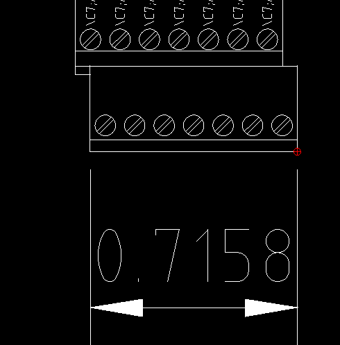

Do dxf files include scaling or dimensioning for the existing values?
When I look at the file Laurent attached in this post (https://qelectrotech.org/forum/viewtopi … 379#p20379), I see a value of 0.7158 for the terminal strip width, for example. That won't be millimetres and inches don't seem to be the unit for the values either. A suitable value might be something like 35 mm, as the terminal spacing (from screw to screw) would then be about 5 mm or 2/10 of an inch.
Since this drawing has to be scaled anyway in order to use it sensibly in QET, it would be very practical if the dimensioning of the values came directly from the dxf file. Then no additional effort would be required to obtain a suitable size of the element.

So doing a quick look into it and found: "
AutoCAD 2000 (AC1015) the INSUNITS variable was introduced. This variable defines the drawing units" so it would depend on what version of DXF as to whether or not I could get this information.
If the files doesn't have scaling we might need to come up with a way to pass parameters to the underlying exe. After selecting the dxf QET has a popup with options that could be added, scaling spline steps etc maybe? I could possible add some GUI and a window to dxf2elmt itself but it will increase the size. If the main GUI interaction is from withing QET it would probably make more sense for QET to handle it, as it already brings along Qt, and dxf2elmt doesn't need to bring it along as a dependency.

The idea of scaling came when I looked at the converted element: The screw terminals are no longer round, but jagged!
This is because we want to limit dxf2elmt to two decimal places due to the file size, but the values for the polygons only differ to the third or fourth decimal place at such small scales.
With auxiliary programs such as dxf2elmt (or QET_ElementScaler) we should limit ourselves to the command line with no further interaction with the user! An additional GUI would probably not fit into the "look and feel" of QET and increases dependencies for the executable. And: We do not know in advance which scaling factor we have to apply here. Most users will most likely not have a CAD program with which they can edit dxf to see in advance which factor should be applied. That is the difference to QET_ElementScaler: There, you stay with the workflow in QET.
Therefore:
If we can read a factor from the dxf file, we should apply it, but otherwise not put a lot of effort into having the user enter a factor.
Then we just have to bite the bullet and increase the number of decimal places to four, for example.
