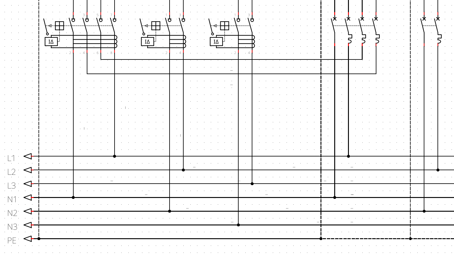

Hi there! I'm a electrician student and I just found this software and it's awesome!
One question: when I connect many wires into one endpoint, too many dashed lines overlies each other and it looks like one solid line. How can I make it look all the way dashed? I hope you understand.
Thank you very much!
solid.png, 45.74 kb, 1486 x 836

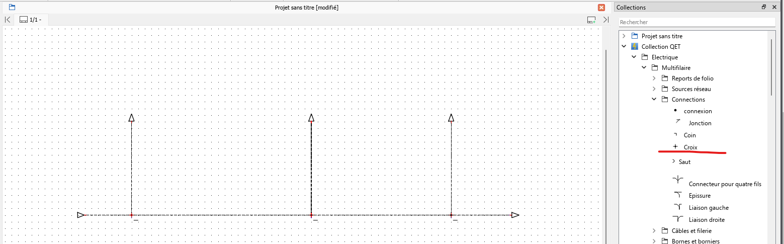

You can use element to do that: your element or from library. See picture.
Capture d’écran 2024-04-23 124902.png, 35.69 kb, 1559 x 485
