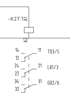

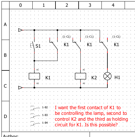

I am using QElectroTech for making a circuit diagram for a CNC milling machine. For that, I will use some relay logic. When I link several contacts to a coil, they appear to be ordered by the folio number and position. Is there a way I can change the ordering, or somehow make the contact number shown?
The first screenshot showing contact numbers for another drawing I found. See the second screenshot for the example I made with explanation of what I want to do.
edit: attachments were swapped, so updated text accordingly.
