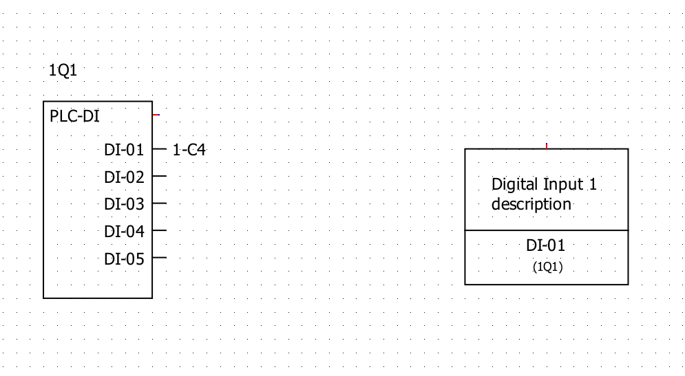

Is it possible somehow to have connected elements on multiple pages?
For example I would love to have a PLC digital input card which has 4 inputs shown as a symbol on one page and then every digital input as a separate part shown on different pages. Then I would like to somehow connect the parts so that the connections and labels would match.
Something like what is shown in the attached picture.
Is it possible to somehow design parts in this way?
Thank you in advance for any feedback.
Br,
Greg

Thank you jhonathan for the reply. Your example is very useful.
I am wondering if we can go a step further and have some connections between the PLC and the digital input so that the labels can be automatically updated.
Is there a way to have some variable that can be used for the label of the PLC that can be also used for the digital input so that both labels can be updated automatically?
Are there any global "variables" that can be used in the label formula that can be used on multiple pages?
Also I am wondering if there is another way to connect the PLC to the digital input / output, because I would like to use a text formula for the wires - concretely I would like to have a page number in the name of the wire for example %id.01. In this way when you try to check something you can quickly find the wire. Unfortunately if the wire go through multiple pages then this is not possible, so this is why I was wondering if there is another way to connect a digital input / output to a "master" PLC.
