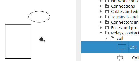

Hello everybody,
I have updated my ubuntu to Ubuntu 23.04 and now i'm unable to drop elements into the folio. None of them neither user collection nor QET Collection. I tried several version 0.9, 0.100 deb and app image and snap. I can draw squares, circles, text etc.
Best regards

To whom it may concern,
I fixed it by removing nvidia driver.
Best regards

Re: Unable to drop element
I am using Ubuntu 23.4 and i have the same problem
Anyone know How to fix this?
Nvidia driver's installed?
