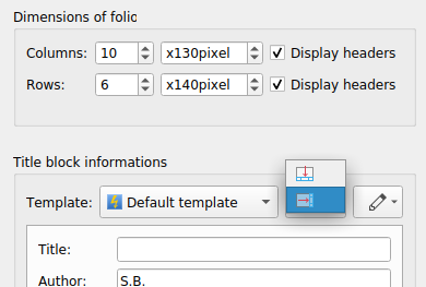

If you open the page properties of the drawing sheet with a double click, there is a possibility to display the title block on the right when you print it out, it then looks as if it was drawn in portrait format. But you would have to rotate your components.
It is probably easier for you to print the special page separately and then insert it with a PDF program, for example split and merge, to get a coherent PDF.

Of course, two different cartouches were made, one horizontal and one vertical.
For some drawings, for example the LAYOUT or a "vertical" wiring diagram (as in elevators), in some cases the vertical title block is more convenient.
Using the rotated horizontal title block does not give a good reading result,  worse...
I had already hypothesized for two different exports and then merge them.
