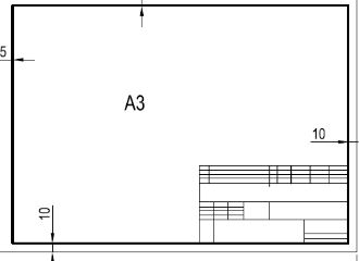

How can i adjust the dimensions I want of my title block so that it is on only one side of the sheet and is not all over the sheet? for example, the right side. As shown in the following image.

It's not possible, but some use a workaround :
Draw your own title block with a big single cell at left.
In your diagram, just hide the upper line of the big cell with white rectangle.
It is the other alternative that I found, the one with the white rectangle, hiding the top line.
I thought there would be another way without having to use it, such as passing the title block to the left or right of the folio.
