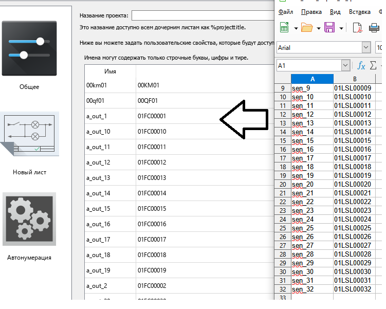

i just need to copy data from table in LibreOffice and insert it to the User Parameters (Propriétés personnalisées)
try'n to insert pic in next reply.
See example provided industrial.qet.

So, how much params i can insert?
255?1024?
I just need to insert tags of equipement into and use them after on pages.
like %{mot_loc}.U1 or %{motor_23}
TY!
