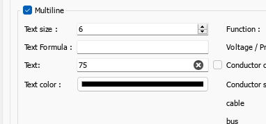

I try to add conductor numbers but sometime the check box can not be selected or the number does not appear on het drawing
what can be the problem?

found:
has to do with the check box on the folio settings:
show one text per folio potential
when set of I can set all conductor numbers
Sometimes it happens to me too. I solve it by selecting the conductor, then ticking the "view" box and then activating it again... the text reappears
