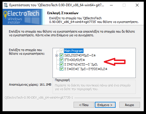

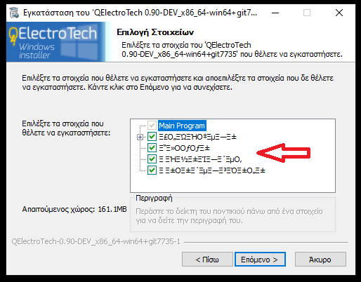

Here some language problems facing during installation of the the latest version of 0.9-dev. When I choose installation language "Greek" the installation wizzard appears strange characters in some installation steps, as follows.
2.PNG, 32.03 kb, 514 x 402

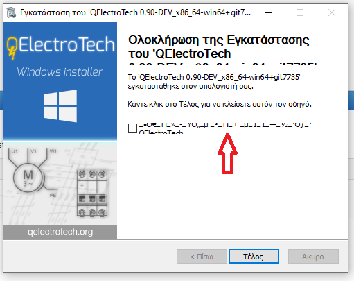

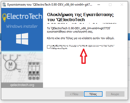

Same here
3.PNG, 47.27 kb, 511 x 405
