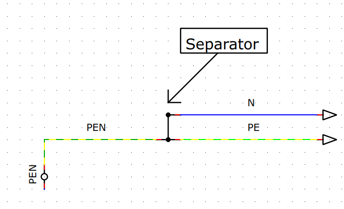

Hello,
when two conductors are connected to one terminal, they have the same properties. In order to separate them you have to insert an element without special properties.
Best regards
Stebo
