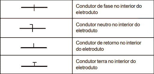

I need to develop a single line diagram but it need to follow some standards.
The phase is OK! But Neutral and Ground is a bit different, Neutral instead of use a line with a circle, it's an inverted "L", while Ground is a "half T", like:
Is there some way to change it?

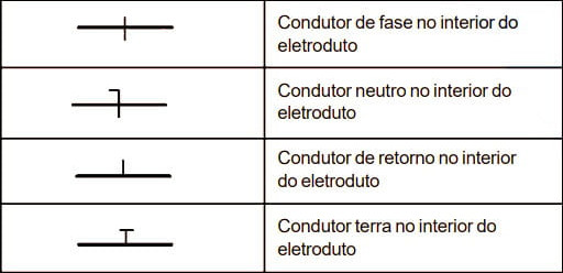

Re: How to change Neutral/Grounds symbol in the single line diagram?
Like this:
https://download.qelectrotech.org/qet/forum_img_2/fagnerln.png
