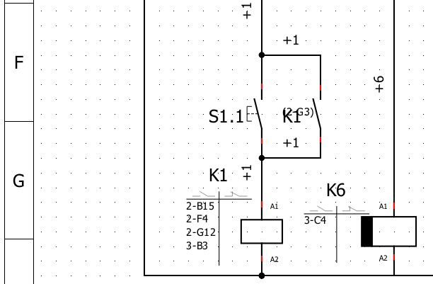

Hello Everyone,
This is me first project in QelectroTech.
I have problem with text that are displayed on second text (see file). I was lokking for problem and can't find any solition.
Help please.
2022-04-08_142302.png, 14.93 kb, 612 x 401
Re: Text on text problem
Hello,
check for each type XRef slave position, like :
https://download.qelectrotech.org/qet/forum_img_2/alexander_xref.png
Thanks for this. I checked all options but it does not help nomicons/sad
Any other idea?
Check for other type : coil, organ of protection, switch / button
You can define where XRefs text that are displayed following the type.
On your capture type is for coil, K1 contact is the slave of K1 coil.
